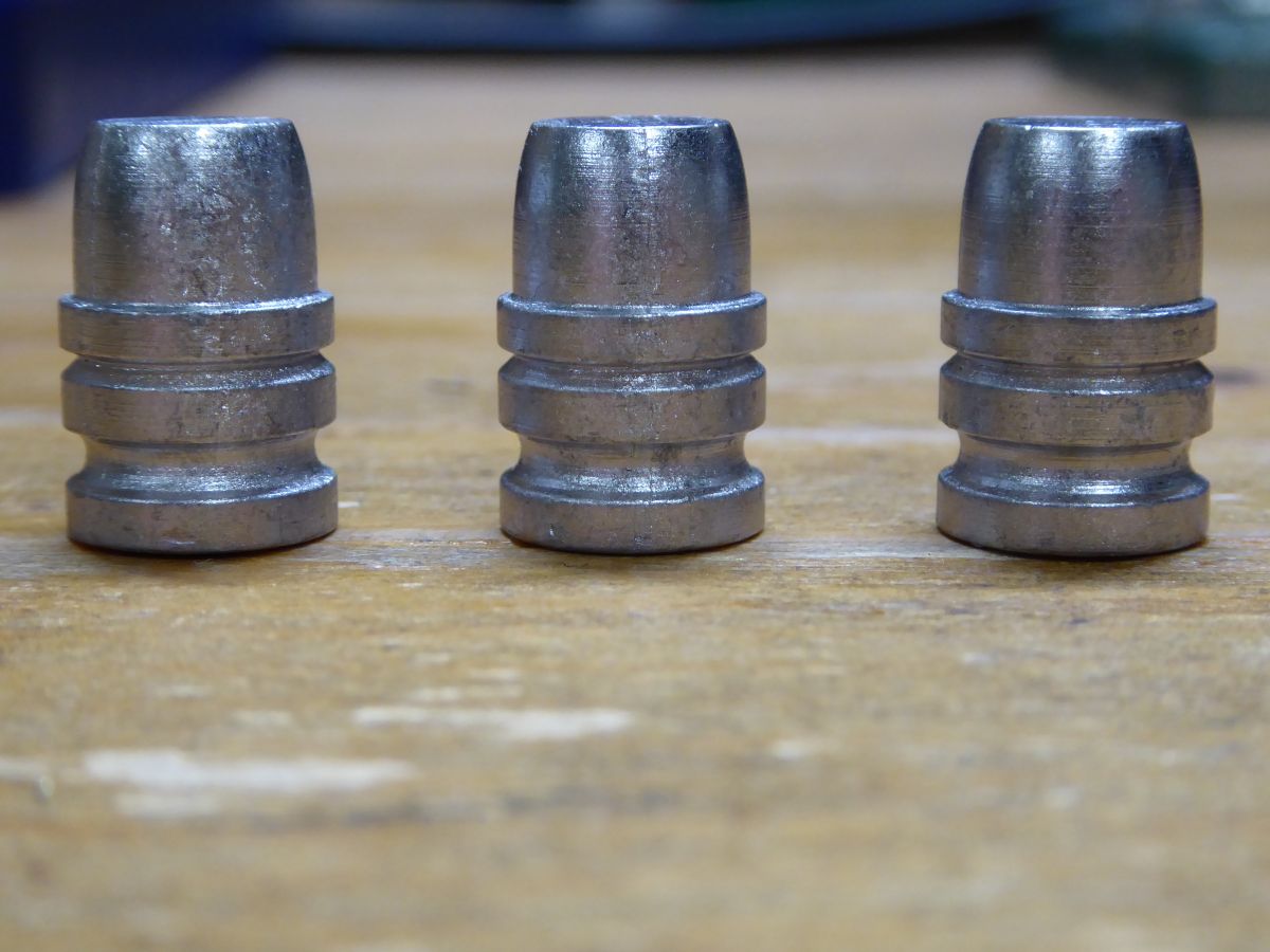

casters here. But those of you that do cast, how much, if any frost do you like on your bullets?
I personally want a cast bullet to be just starting to show a bit of frost, not a real shiny bullet nor a heavily frosted one. There is not a thing wrong with either side of what I want a bullet to look like, I have shot lots of both. It's just what I try for.
Just a little something I was looking at today and wondering what others do. Hope the picture will show it.

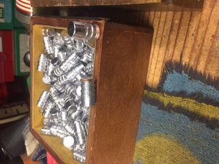

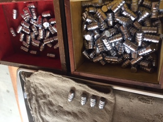

When I use a harder lead, I let it get hotter before I start pouring, and they seem to cast shinier. I get more frost on heavy bullets like casting 525 grain 510’s as you use lead so fast, it is a little cooler. That’s just what I notice.

generally frosting is an indication of mould temperature, cooler shinier, hotter frostier. I don't have a pot thermometer so I can not tell you within 50 degrees of what I cast at. For my casting and the bullet look that I want I run my alloy and more importantly my mould at a temp that takes 3-4 seconds for the spur to solidify, hollow points a second or two hotter.
I think on your heavier bullets you are pouring more alloy (heat) into the cavities making your mould hotter thus frosting your bullets.
