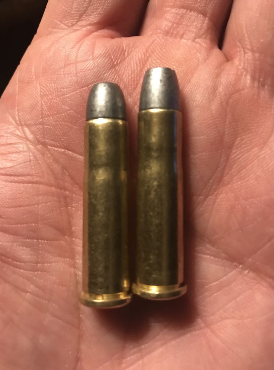

I used to get bulges on one side seating the bullet. I figured it was too tight (.308 spec.) sizers and seating .311 bullets. I found if I used the flaring die provided with that particular set it worked much better. I was previously using a universal flaring tool
Today I'm getting heavier crimps on one side than the other. The bullets I'm using do have a very deep crimp groove. I could have just seated deeper and barely rolled the crimp in. I did need to flair just a bit to prevent bullet shaving. I used the 113 gr. (my measurement) bevel base .313" flat points and 3.0 gr. Bullseye for maybe 850 fps for my old Colt. I hope to give the old man a run this weekend.

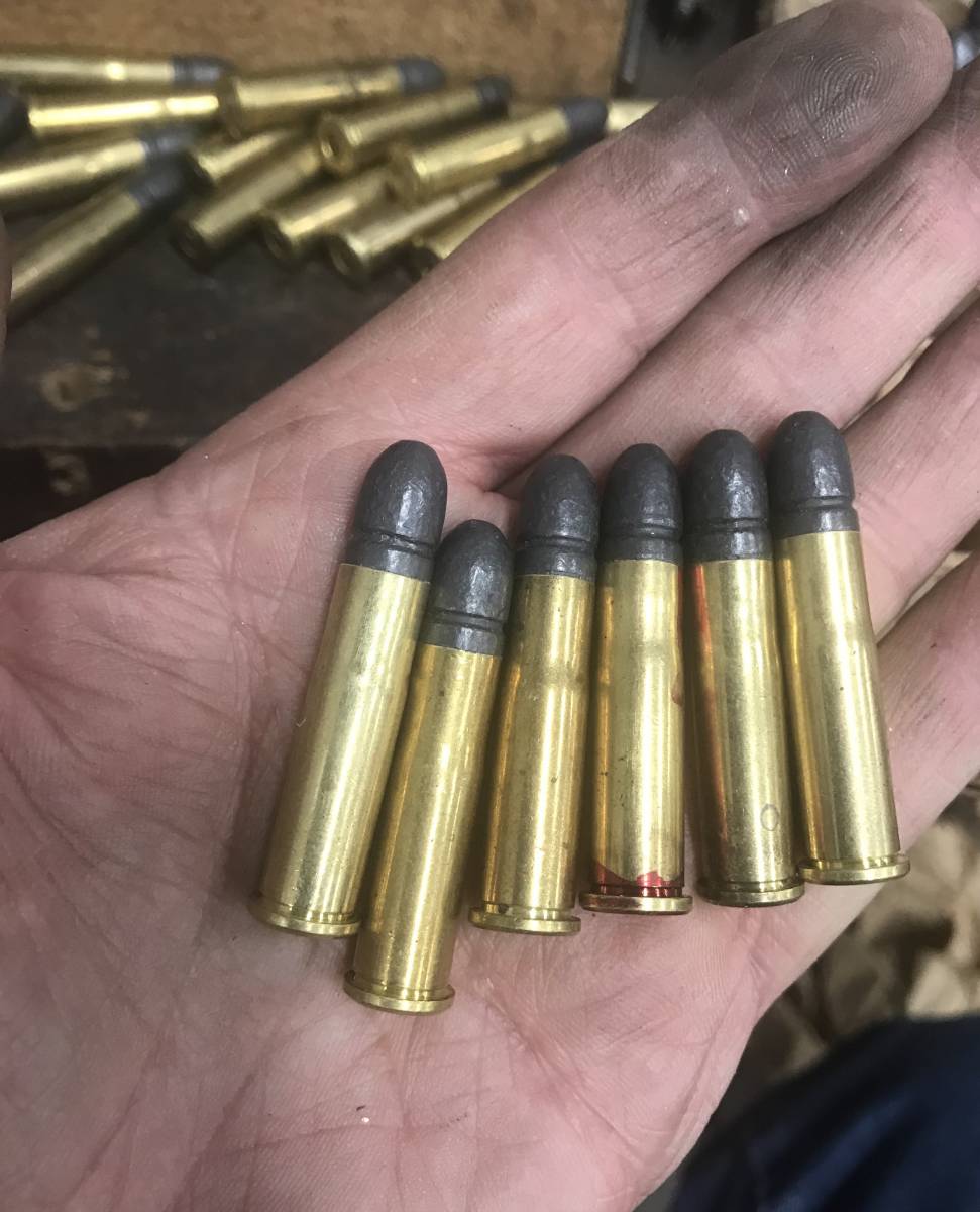

Chris you are right. Out of 200 primed Starline
Thursday, January 07, 2021, 20:10 (2132 days ago) @ ChrisG
I seem to be having about 4% malformed necks. No prob though. I trim back to 1.250” for the .310 Cadet rounds.

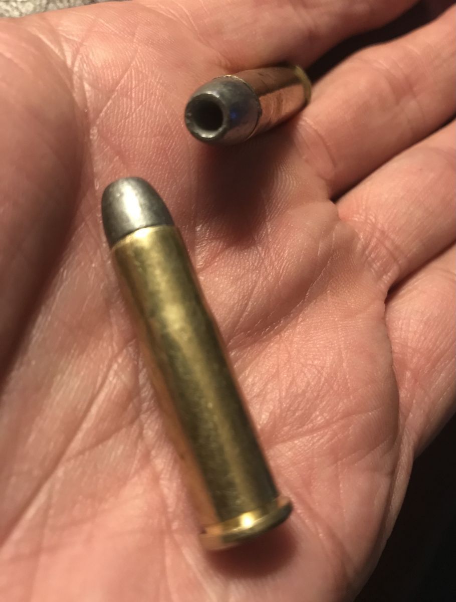

But not in that cal. If I had a lever gun I’d probably run and get one. I had a bullet or two that Huey hooked me up with that had a different profile than mine. It’s shallow groove did not lose uniformity in crimping. I think the other just had too deep a groove and the thin brass.
That Huey bullet might be the ringer for my old Colt limited to lower pressures. The HP boosts validity considerably. I loaded some in .32 S&W too for my little Pocket Positive.
