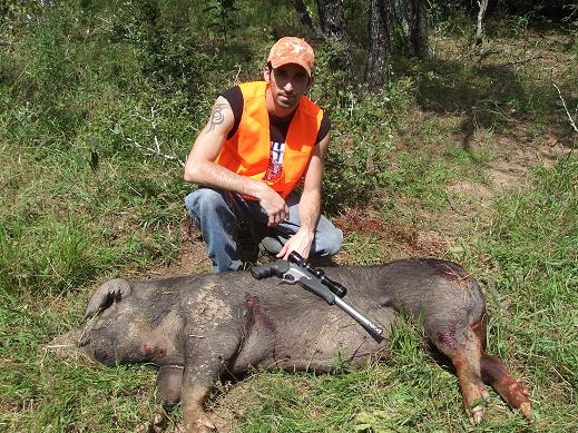

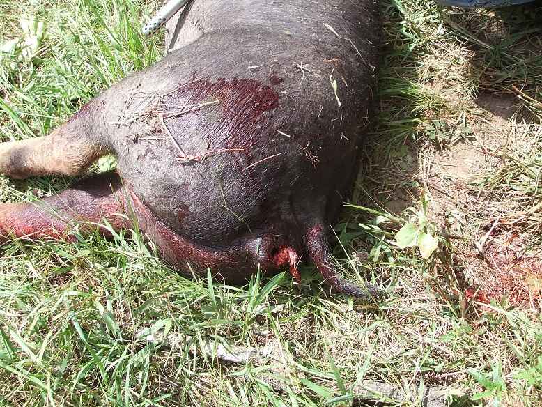

mid summer and it lived up to his name. Kase shot a big hog up the ass with that 10mm and those lightweight bullets. he hit the hog 3 times and finally finished the hog off with his 378 GNR. But the 3 rounds of 10mm went all the way thru most of the hog and ended up in his lungs. A bit heavier bullet would have probably done a bit better but the 135s at least slowed the hog down enough for a finishing shot. A pic of that hog with bullet holes in his ass is included here. I think we had maybe 15 Misfits at that hunt. It was Hot & Nasty but still a good time. Even got to do some night time hunting out of deer stands.
