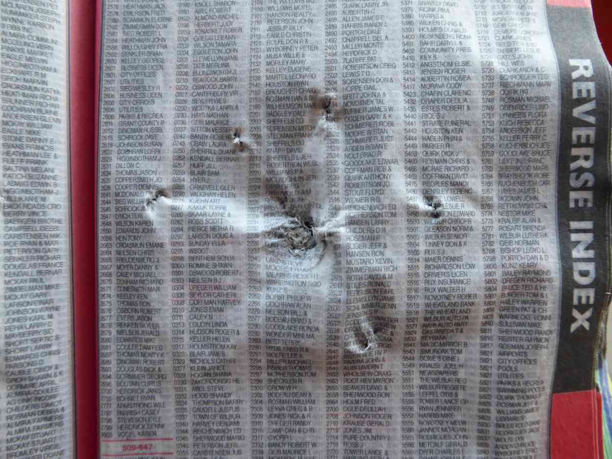

After results similar to yours, I have
Mark Conner
Friday, January 08, 2021, 19:49 (2131 days ago) @ Jim Taylor
been playing with different alloys. Generally, I have shot a 50/50 mix of wheel weights and pure lead water dropped in a LBT WFN or LFN style.
I am thinking for Deer next season that I will try a 16-1 alloy in either the 454424 or a LBT LFN-HP out of the 455 GNR.
Matching alloys for chucks and coyotes with the 300 GNR, I think my old standard of wheel weights and pure lead water dropped is about perfect. The nose is brittle enough that it completely comes apart.
This is the 100 gr. LBT HP out of the 300 GNR at about 30 yards in wet pack phone books.
