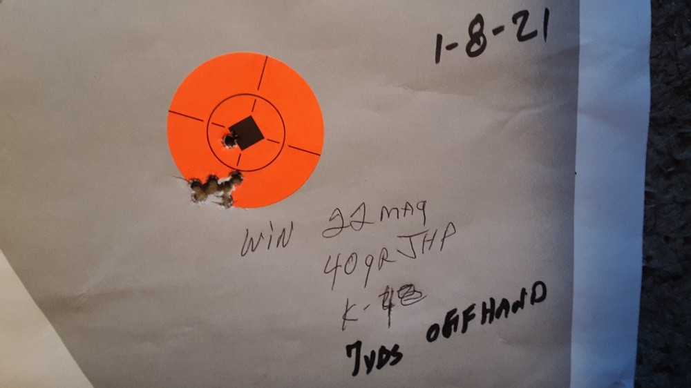

Scott, My S&W Kay Chuck with 8 3/8" gave
james
Sunday, January 10, 2021, 13:48 (2129 days ago) @ WB
me an average of 1658fps shooting 35gr V-max over 8.0grs of 2400 while 9.0grs of 2400 averaged 1754fps compared to a CCI 40gr 22mag at 1402fps from 6" S&W M-48.... However, I just shot this group off hand at 21ft from my 6" S&W using Winchester 40gr JHP ammo...[image]
