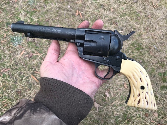

It shot 8” low at 25 yds. I trimmed 0.010” off the top of the front sight, it seems to have moved impact 3”. So for 5” more works out to 0.017” more? Does that sound about right?

Regulating an old .22 fixed sight pistol

About that amount yes
- steve todd, 2021-01-22, 22:07
- That works pretty good. I just use a marker temp. - WB, 2021-01-22, 22:42
