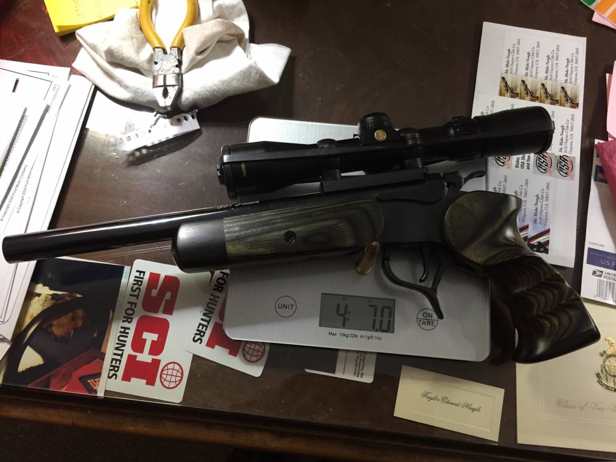

I like light wait gear for sure but, my 12” G2 in 361 Falcon
Blake
Monday, January 25, 2021, 16:29 (2114 days ago) @ John W
Only weighs 4.7 lbs scoped and loaded. Even I can carry that
All day. How light do you need. At some point the trade off will
Effect performance. And cost has to be weighed into the equation.
Sorry, couldn’t resist!
Scale
Blake
Monday, January 25, 2021, 16:34 (2114 days ago) @ Blake
what is the hole in the side of the forend for?
