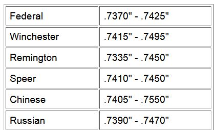

After cleaning my empty cases I sorted them all according the headstamps. Before sizing , neck expanding, and priming the cases I decided to check them for over-all length (OAL). To my surprise I found that the cases varied by as much as .020" in length. Using six different brands and checking ten of each, I found cartridge cases ran from .7355" in length to .755" for the long ones. This large variation can means that some cases are not headspacing on the case mouth as supposed, but rather are headspacing on the extractor. This could account for sloppy accuracy in itself.

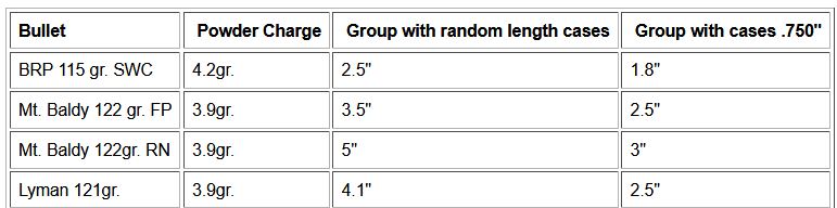

After studying the results of my shooting tests I decided to see if it would hold true with cast bullets. Using what I had learned from the previous tests, I used only 2 different lots of cases. One lot was cases picked at random and not measured for length. The other lot was cases of .750" length. The bullet diameters were .356", more closely fitting the bore diameter of the Colt Combat Commander. I used four different bullets during this phase of firing. One was a nice semi-wadcutter from BRP High Performance Cast bullets which weighed in at 115 gr. I also had 2 bullets from MT. Baldy Cast Bullets, both of 122 gr weight. One was a flat point (FP) while the other was a round-nose (RN) design. The last cast bullet was one I cast myself. In a pointed shape, it was Lyman's version of one of the old original Luger bullets. Weighing in at 121 gr., the Lyman number for this design is #356402. Again, testing confirmed that in this gun at least, cases of .750" length shot the most accurately. As I have stated before, you will have to find what case length shoots the best in your particular firearm. However, this is a good starting point.

Case length variations (only the largest and smallest given for each lot):
LOADS WITH CAST BULLETS - ALL BULLETS .356" DIAMETER - ALL LOADED IN SPEER CASES - CCI #500 PRIMERS USED THROUGHOUT - ALL FIRING DONE AT 25 YARDS FROM A REST USING AN OUTERS PISTOL PERCH - ALL GROUP AVERAGES ARE OF 6 5-SHOT GROUP - ALL LOADS WITH HERCULES BULLSEYE POWDER

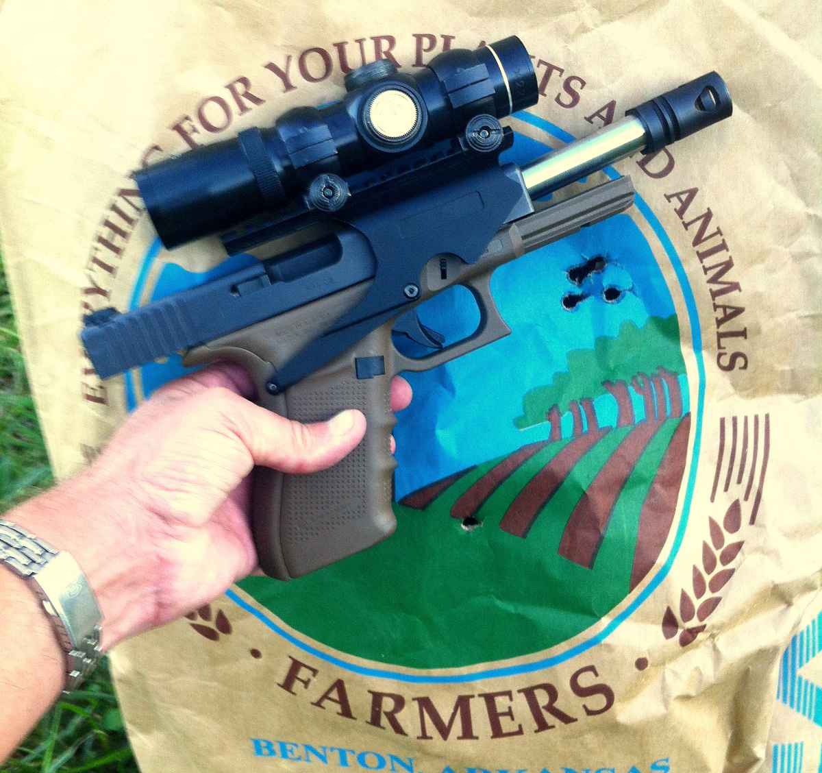

the limits on headspace and not letting the locking lugs close consistently. Too short cases might get into inconsistent ignition and longer ones not letting lock up return to the same for each shot. Modern Glocks spec at the far end of SAAMI limits. They can easily headspace off the extractor too for shorter cases. They shoot about anything with exceptional accuracy. If you could get a Glock in some fixed rest I have no doubts they could shoot sub 2" groups at 50 yds. I have done that with my Glock in .45 and 10mm, scoped off the bench. They are not normal guns like 1911's. There is no reason they should shoot as good as they do but there you go.
