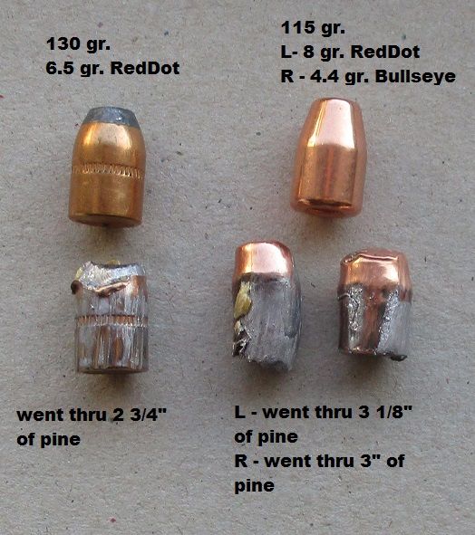

Shooting into 1/2" pine boards stacked up ...
The Red Dot loads are fairly stout but not top end. The 130 gr. JSP is a .357 Magnum bullet I got from Precision Delta. They are .356" ... I ran them through a Lee Bullet Sizing Die and they come out .355" ... and have no issues feeding or chambering in my gun.

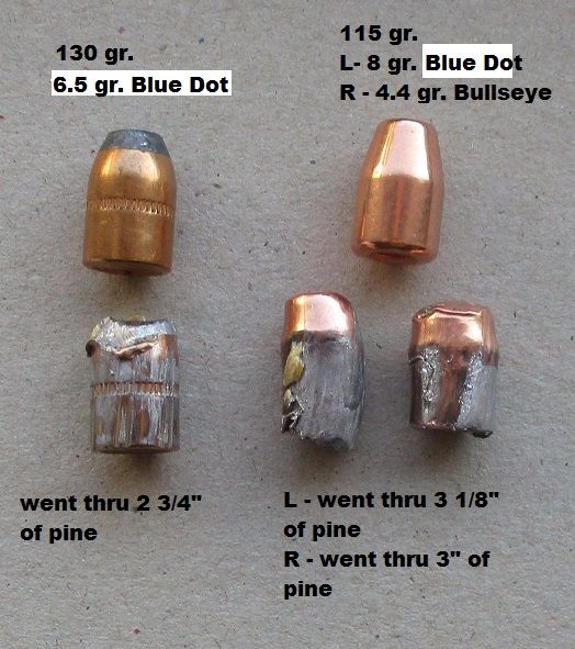

the loads posted above should read Blue Dot
