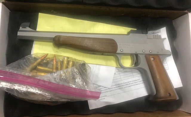

It's in 7mm Rimmed International, actually a improved .284/.30-.30. Not to be confused with the 7x30 Waters. This case has several differences but about the same capacity. I only loaded 27 gr. H335 with a 130 gr. JHP but the velocity forming cases was a lackluster 1800 fps from the 10.5" barrel. Not really inspiring. Also recoil is really notable which surprised me. That's .357 Max. territory in a 4 lb. gun. But the backstrap is flat steel too. Adding 300 fps and thinking of shooting 200+ rnds in a match would wear on you for sure. I'm jaded that Gary's muzzle brakes work so well. My 7mm GNR has that same bullet running 2400 fps easily and has almost no recoil! I'd want this thing Mag-na-ported for sure.

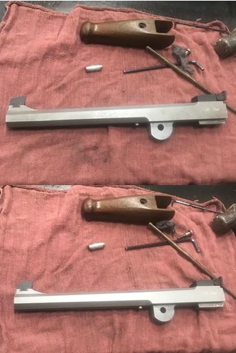

Stainless does rust. I had to take care and carefully clean this old iron.
