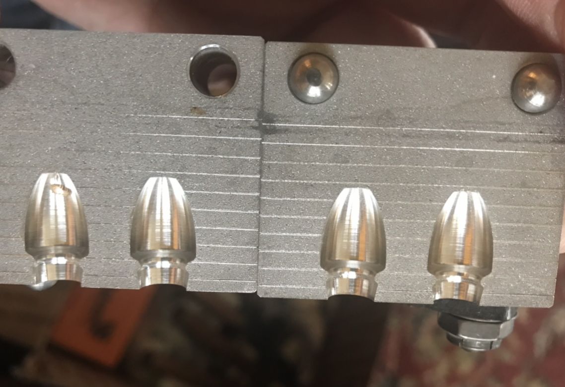

I think I have identified the odd NEI one I collected.
![[image]](images/uploaded/20210210010340602330ec5a5d4.jpg)
The SLP was a two mould set. The one I have is the nose piece (SLP) to be cast soft. The mate was a "base" with gas check and designed to be cast of harder alloy to be driven fast once the soft nose was glued/bonded with it.

I was inquiring if someone may have bought the other Mould and found it an odd looking hollow point wadcutter looking thing? If by happenstance that is possible, we need to get together, figuratively speaking. LOL

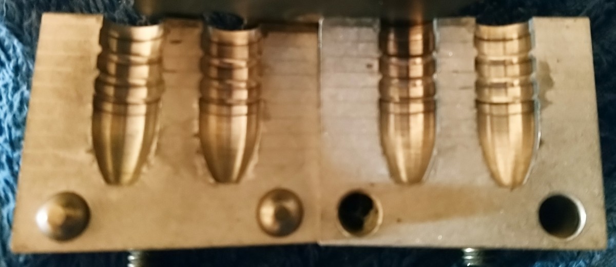

Tuesday, February 09, 2021, 20:54 (2099 days ago) @ WB
I have it. it appears as a normal gas check mold.

I was researching and have not found it exactly

but there was an article listed citing the "SLP" bullet mould. One fellow thought he remembered that you cast the nose soft, then inserted it into the other mould and poured a base onto it.
Maybe... the funny nose mould I have does seem to look like it might copy that mould profile. And I guess the configuration of the appendage out the rear might lock it on when you try to cast the base. I do know I had a devil of aa time trying to "double pour" in a conventional mould. The lead would separate, not blend. Until I heated and melted the lead while in the mould with a torch.
