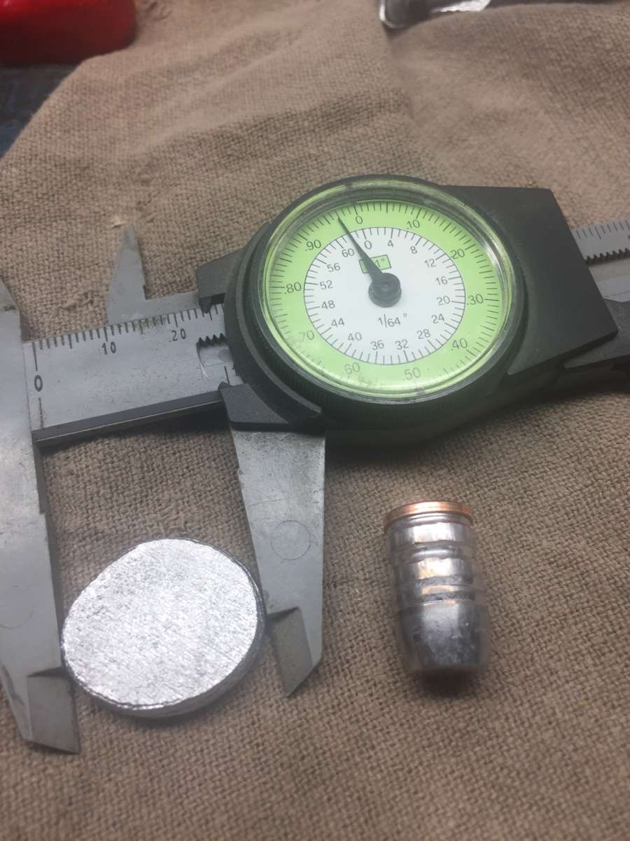

Wednesday, February 10, 2021, 20:55 (2098 days ago)
![[image]](images/uploaded/202102110348366024a914aa6c8.jpg)
Here’s what a .454/300 grain bullet looks like after 15 pretty hard hits with a 2 pound sledge, on an anvil. It took the 3rd or 4th hit before it was no longer loadable. It ended up the size of two nickles, with no cracks, fragments or splits.

with WB on anything that shoots. For around a hundred years now I have been casting. Mostly wheelweights with a piece of linotype about as thick and long as my litle finger. I cast one bullet, let it cool and put it on an anvil and hit it with a hammer, pretty hard. If it shatters, too hard. If it mashes way down, too soft. If the nose just deforms a bit, then it is OK for me.
I also try the thumbnail trick. If I can scratch it fairly deep with a thumbnail then it is too soft. If I can just make a shiny spot with my thumbnail then it is OK. I very seldom use gas check even though I have a gazillion of them. The standard bullets like the 44 mag 429421 I load for the 44 Special shooting here in the shop. It is a bit heavy but is accurate. Another one for the 44 Special is a 215 grain SWC. I don't remember the mold number but it works too. That is for guns that are lighter and a bit more fragile.
Like you mentioned I don't go by any special secret formula as most of that is BS anyway. lead composition changes just as wheelweight composition changes. If they were all the same a formula would be fine but they aren't. I used to buy the big 2 foot long 25 lb bars of linotype but those are really hard to find these days. I also found that monotype and linotype were different even though they were mostly used in type setting businesses. The monotype seemed a bit harder than the linotype. Years ago when I lived in Nashville I used to buy buckets of both monotype and linotype from the Methodist Publishing House.
Anyway, I know that my bullets are either too hard or too soft by the hammer and anvil test. Old fashioned but it works for me.

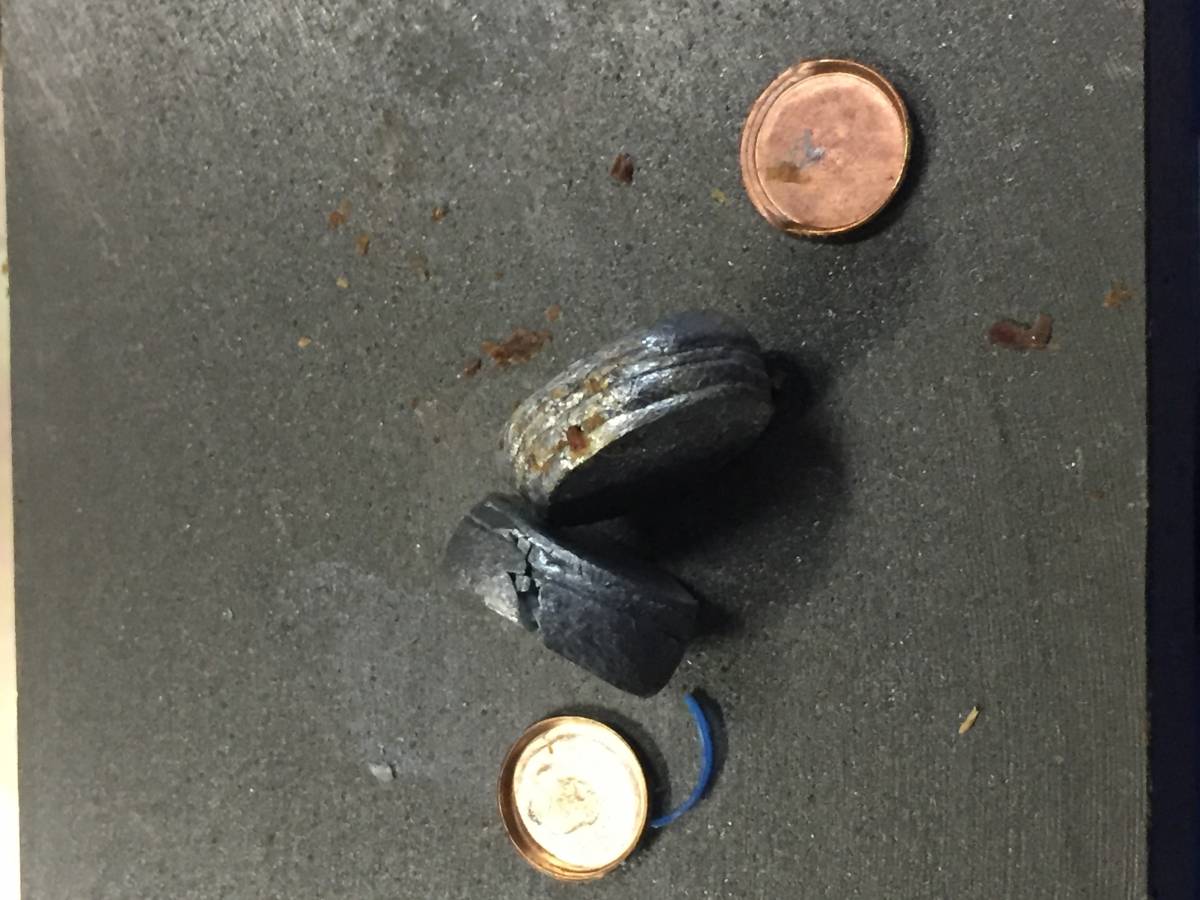

I will try a cast Performance Bullet
MTM
Thursday, February 11, 2021, 08:28 (2097 days ago) @ Jim Taylor
Next to one of my hardcast on the anvil for a SxS test. I do gas check any bullet that I will load over 1100 FPS. I will be taking premium jacketed bullets to Africa though.
Cast performance vs home cast
MTM
Thursday, February 11, 2021, 14:06 (2097 days ago) @ Jim Taylor
![[image]](images/uploaded/2021021121031660259b948ab3a.jpg)
With an even amount of hits, the cast performance Bullet started cracking. Granted this is being slammed between a 3 lb sledge and an anvil 15 times. Not sure what it proves, but I’ve never had one fail me.
Just used it at the HHC, and dropped a hog, one shot.
If you can smash it that far beforre it cracks
Thursday, February 11, 2021, 14:43 (2097 days ago) @ MTM
it's not too hard or too brittle.
