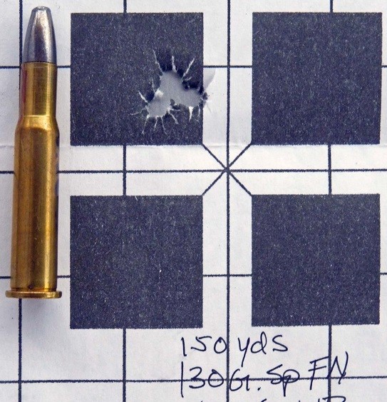

Heavy loads in the 30-30 Trapper with Mag Pistol Primers ..
Monday, March 01, 2021, 14:51 (2079 days ago) @ Gary Reeder
never gave an indication of pierced primers. Shot quite a few testing them .. running the 130 gr. Speer up past 2500 fps from the 16" barrel.
I don't know how they would work in other types of rifles but I know of more than a couple individuals who regularly use Mag Pistol Primers in the 30-30 Levergun.
Group fired with Magnum Pistol Primer
Tuesday, March 02, 2021, 07:31 (2078 days ago) @ Jim Taylor
I DID NOT SHOOT THIS GROUP! THIS WAS FIRED BY SOMEONE ELSE. VELOCITY IS 2750 FPS WITH THE SPEER 130 GR. HOT-COR BULLET. THE GUY WHO SHOT THIS SHOOTS GROUPS SIMILAR MORE THAN A FEW TIMES.
Iron sights Jim?
backroadsrambler
Tuesday, March 02, 2021, 13:33 (2078 days ago) @ Jim Taylor
And if so, OEM or peep? Thanks! =o)
No.. His gun is scoped .. maybe 12X? not sure...
Tuesday, March 02, 2021, 14:23 (2078 days ago) @ backroadsrambler
Thanks Jim! I feel a tad better...
