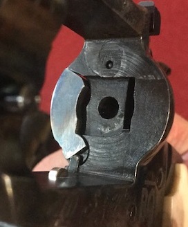

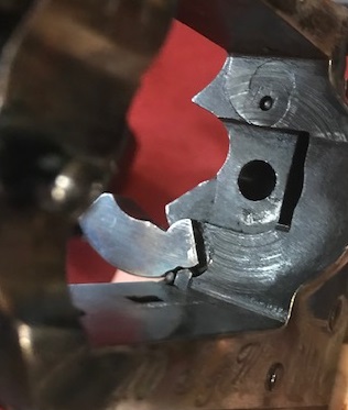

This is a Single-32 chassis in .40. It's fine, really. But the gate is a little bit stiff. This manipulation and mechanics have always been a bit of a mystery. I know it can be problematic with heavy kickers. This seems fine except maybe some geometry. The gate goes out and it has to push the spring tip straight down.
I see some angle on the spring tip that might create a stiffness on the break over. Is it possible a bit of stoning to round the tip some would make the transition smoother?
I'm not trying to get the work done, I'm more trying to understand the dynamics. It's functions as is. I also note it moves a touch forward just sticking your thumb in to open. It's easier to take the effort to ensure it rotates precisely 90 degrees to rotate straight out. Pushing on it presses against the spring while you are trying to force it down too.

Angle of the tip of the spring
Tuesday, March 02, 2021, 08:47 (2078 days ago) @ WB
Ah, just the opposit what I was thinking. Thanks!

when we get them in from Ruger they are rough with no sharp
Tuesday, March 02, 2021, 12:37 (2078 days ago) @ WB
edges or rounded edges, pretty much a square flat top. Each gun is different. Some need a rounded top edge so the gate will roll over it while some need a slanted edge like Jims to open smoothly. I have seen factory new guns come in so hard it takes 2 thumbs to open the gate.
I'm gonna kiss it with a stone and see if it helps a little,
Tuesday, March 02, 2021, 13:41 (2078 days ago) @ Gary Reeder
all I really need. I'm fine tuning. I can see the geometry Jim is pointing out. An angle would help push the spring down without binding. Mine has just a touch, I think a little more might help.

I polish the round part of the loading gate the spring
Asa
Tuesday, March 02, 2021, 18:12 (2078 days ago) @ WB
rides on, and just knock the burrs off the spring. I leave the highest point alone and maybe lengthen the lower point. If you shorten the higher point you take a chance at the gate not staying shut, the angle holds it closed, and the worse case is it will no longer drop the bolt and clear the cylinder.
