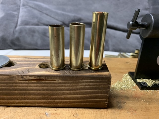

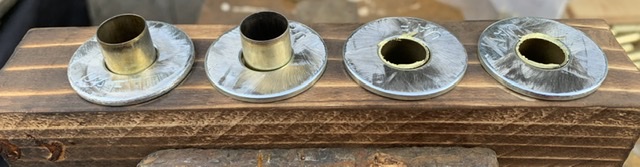

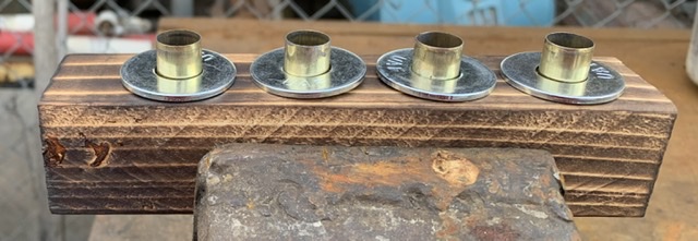

500 maximum jig
Tim Dollar
Friday, March 12, 2021, 19:05 (2068 days ago) @ Tim Dollar
Ok made a quick jig to cut 50AK to 509 Maximum ![[image]](images/uploaded/20210313020248604c1d484056e.jpg)
![[image]](images/uploaded/20210312202617604bce697b308.jpg)
![[image]](images/uploaded/20210313020447604c1dbf9912a.jpg)
![[image]](images/uploaded/20210313020511604c1dd7be3ef.jpg)
