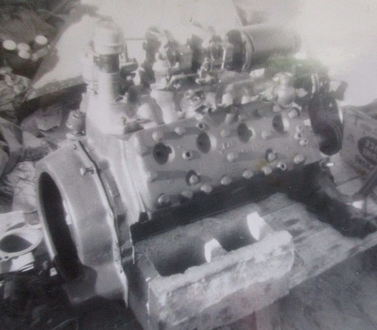

ENGINE
1953 Ford V8
Bore 3 5/16"
Stroke 4"
276 cubic inches
The engine was bored 1/4" and a Mecury cranshaft was installed. The cam was ground to "3/4 Race" configuration. Adjustable lifters were installed. The block was ported and relieved. The heads were milled 1/16" and Mallory dual-point ignition was installed. The flywheel was lightened and ran a 10 inche truck clutch and pressure plate. The Edmunds intake manifold held 2 Stromberg 48 carbureators. Fenton headers were used for the exhaust. I used an 8 volt battery to crank it, the compression being too high to crank with 6 volts. I had the regulator adjusted to charge 8 volts and it worked fine. The lights on the car were nice and bright .. though some did not last too long.
![[image]](images/uploaded/20210501181243608d9a1b54781.jpg)

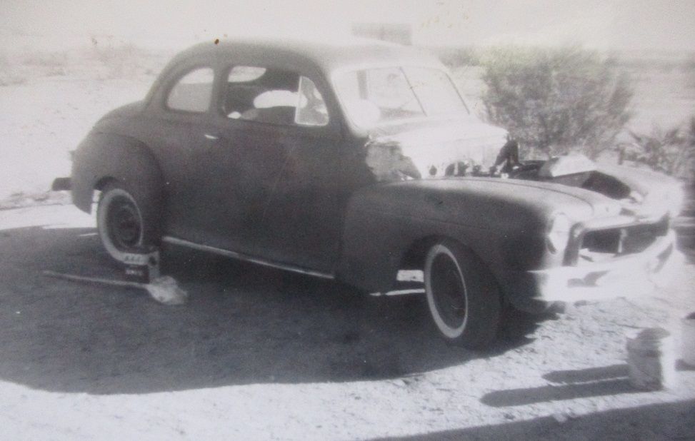

THE CAR
1947 Mercury Coupe
Featured a dropped front axle to lower the front end.
Transmission and rear end were stock.
![[image]](images/uploaded/20210501181320608d9a40ec14b.jpg)
My First Hotrod ..

How did you keep it cool? (nm)
- Charles, 2021-05-01, 17:50
- The big Merc radiator ... - Jim Taylor, 2021-05-02, 05:59
