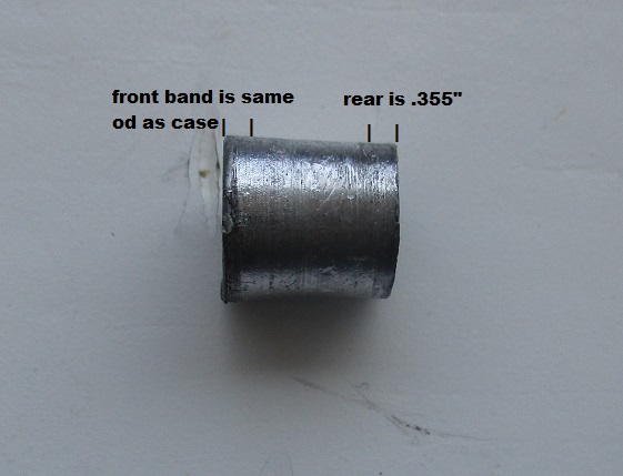

The bullet was designed to just slip into the cartridge and be seated by finger pressure. The larger diameter front band made it necessary to use a cartridge slightly shorter than normal, as the band on the bullet was against the cylinder throat. This acted like a crimp and kept the loads from "pooping" ... it allowed them to build normal pressure just the same as if it were crimped.
in .357 used a .38 Special case
in .38 special used a .38 Long Colt case
in .44 Magnum used .44 Special case
in .44 Special used .44 Russian case
in .45 Colt cases were trimmed .120" or so.

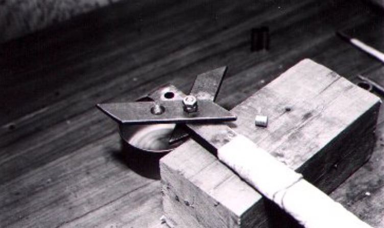

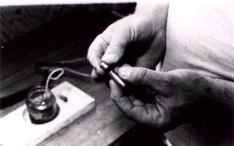

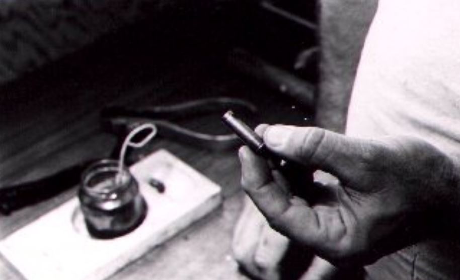

Years Ago my Dad produced and sold bullet molds ...
