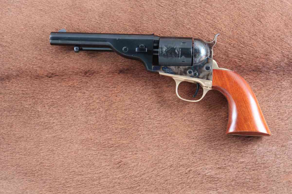

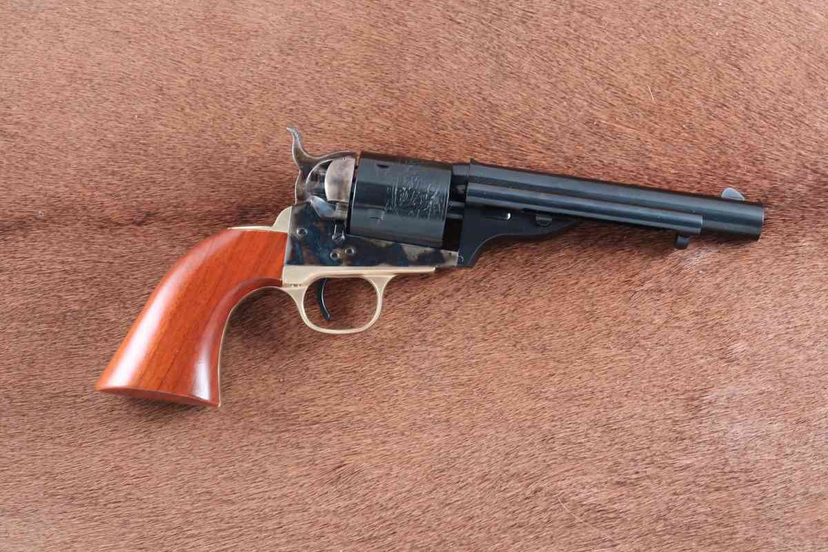

WB THIS CFA/UBERTI
Friday, May 14, 2021, 08:47 (2005 days ago)
OPEN-TOPARRIVED YESTERDAY. NICELY FITTED AND FINISHED.
[image][image]
Man that makes my hands sweat!
Friday, May 14, 2021, 09:13 (2005 days ago) @ JT
What a unique transition model from the C&B o the 1873. I LOVE the rear sight. No matter on regulation, at LEAST you can see it!
I like those!!
Derek
Friday, May 14, 2021, 10:51 (2005 days ago) @ JT
Looking forward to your review! Is it 45 Lc or 38 spl?

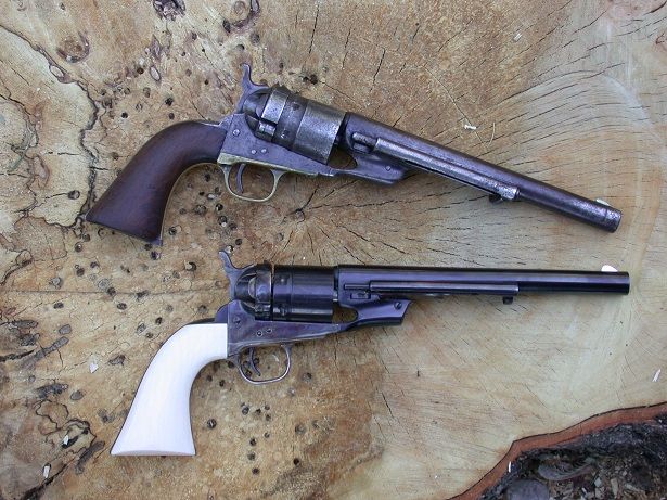

CURRENTLY I HAVE
Friday, May 14, 2021, 14:45 (2005 days ago) @ Derek

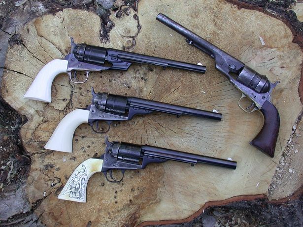

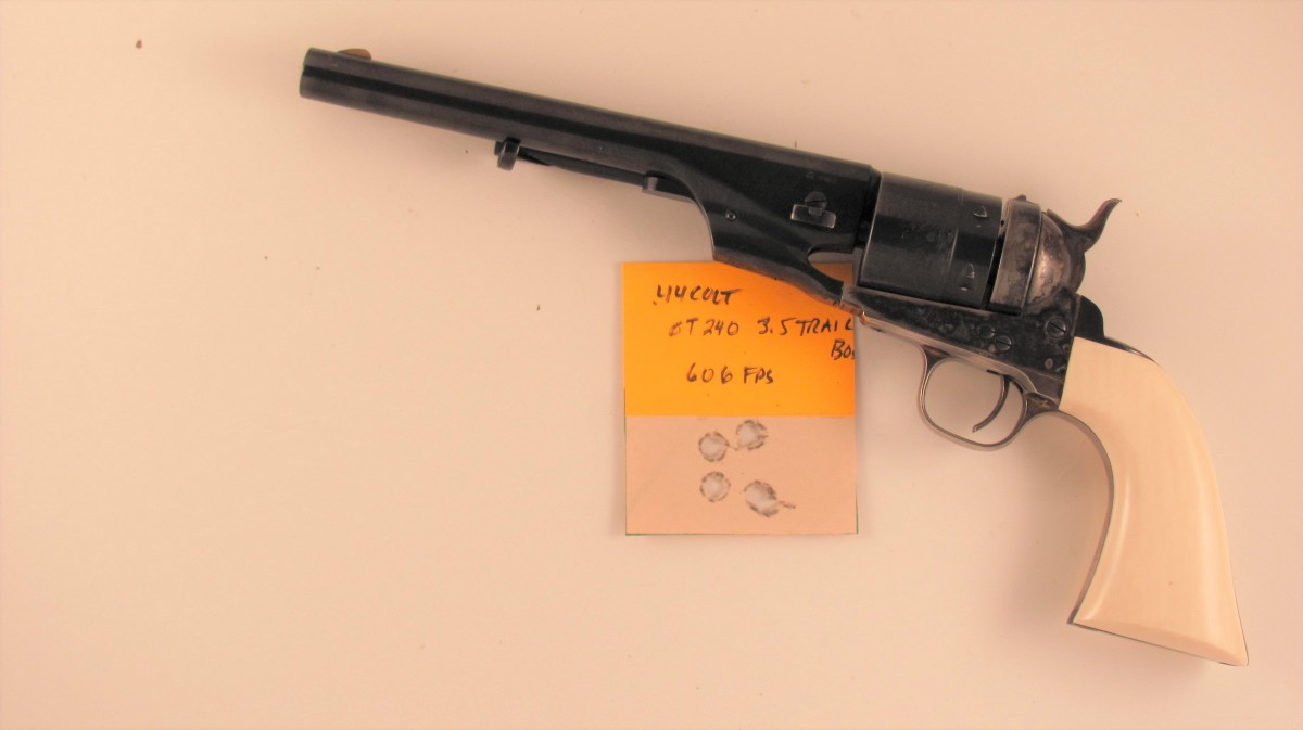

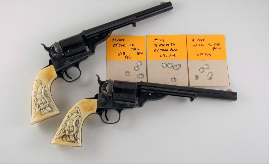

5-1/2" C.C./O/T. EXAMPLES IN .44 SPECIAL. ,.44 COLT AND THREE .38 SPECIALS.THE LATEST ONE PICTURED IS A .38 WHICH WILL SEE .38 SPECIAL, .38 LC,.38 LC LONG CASE, AND .38 SHORT COLT LOADS
I ALSO HAVE THE LONGER BARRLELD VERSIONS
Friday, May 14, 2021, 14:50 (2005 days ago) @ JT

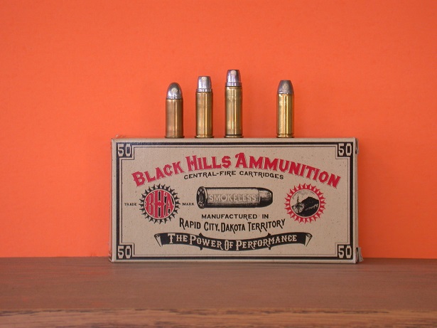

IN .44 COLT,.44 SPECIAL, .45 SCHOFIELD. The first Cartridge ConversionS/Open Tops from Uberti were chambered in .44 Colt and would not take either the shorter .44 Russian or the longer .44 Special as the rims on the latter two have a diameter which was large for the size of the cylinder. At one time, a very short time, it was possible to purchase 4 IN 1 brass which was the same length as the Russian but with the rim diameter of the .44 Colt thus allowing it to be used in those original Uberti .44 Colt sixguns. Currently Ubertis are available chambered in .44 Special which allows them to use all three of these cartridges.
.44 COLT: Original and Uberti +
Friday, May 14, 2021, 15:02 (2005 days ago) @ JT
.44Russian, .44 Special, .44 Magnum cartridges compared to the .44 Colt.
