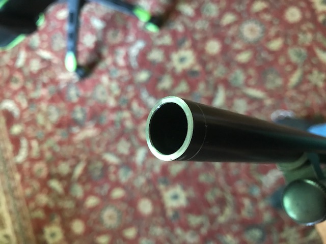

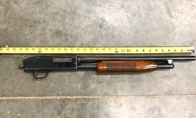

We took a link out of his motorcycle chain too. Things a man needs to know how to do. We whacked the barrel on the Mossberg. I checked the ATF federal limits and the barrel need to be over 18" (this was a original production "shotgun" so trying to make something else from it is dicey) and an overall length of over 26" with any stocks mounted and or folded. I like a little extra room so the barrel is just under 19" and mechanical OAL even w/o the pistol grip is just over 27", the way I wanted it.

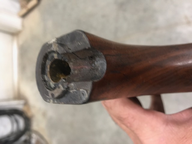

The walnut buttstock was is much worse shape than I knew. Repairable but it's going to take a couple passes with hardwood 1/4" dowels and Accraglass, lots of sanding and staining. Maybe later.
By far the easiest method to cut the barrel is a hacksaw. It is difficult to get it straight and square. It can be done but I cheated, chucked it in the lathe. Benj liked that too.
I'm torn between drilling and tapping the end of the barrel for a fiber bead (I'll likely finally do that) opposed to one of the plastic clip on beads quite popular today.
