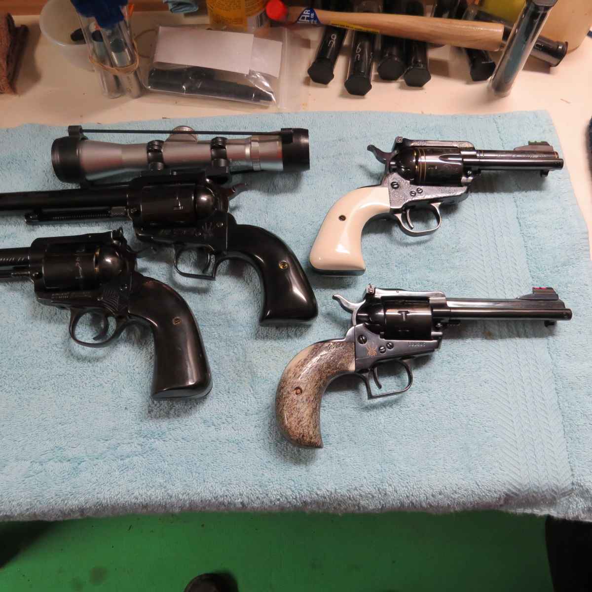

To each their own....LOL while I agree with most of WB's
jthomson
Friday, June 04, 2021, 20:16 (1984 days ago) @ WB
statement, it simply does not hold true for me personally, I have one of the field grade FA83 models in 454 and have no problems with the Pachmayr rubber grips , in fact I prefer them, the reason is they are larger than the hard grips and seem to fill my hand better. They do however feel loose on the frame to me. I have several of Gary's guns and I will admit that the "Gunfighter" configuration is a vast improvement, the only gun I own that slams into my knuckles is the Bisley, just not enough room between the trigger guard and the grip. not the Lwr Left grip compared to the Upper Left Superblackhawk frame ( my favorite) RH Upper is the std Blackhawk, and the Lwr RH a Trailrider conversion on a Superblackhawk Gripframe. All Gunfightered. The only problem I have with Gary's grips are that they are so smooth I feel like I can't get a good grip on them, however the comfort outweighs that notion. All in all my hands favor one thing and yours will favor something else[image]
