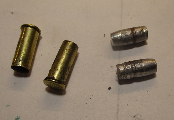

While back Denning sent me a bunch of primed .22 LONG RIFLE cases. I did not have the proper bullets but had reloaded a couple just to get a feel for it.

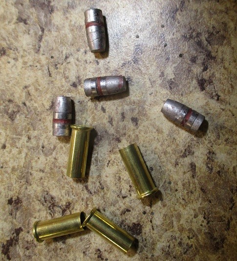

Just before I left last month to go to my daughter's and then on to The Shootists Holiday, Sean sent me a bunch of 40 gr. cast gascheck bullets. I have not measured them but figure they are .223" or .224".

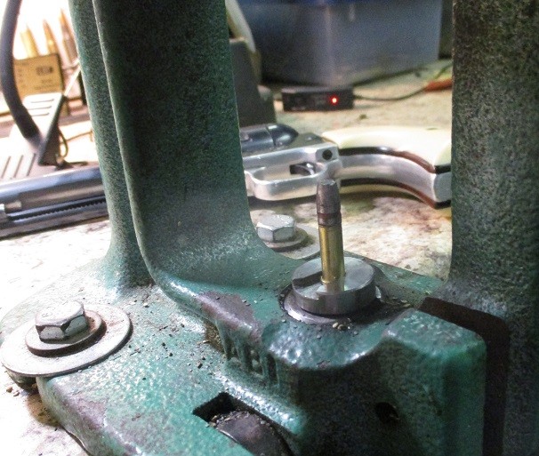

SEATING THE BULLET (there ain't much to grab onto)

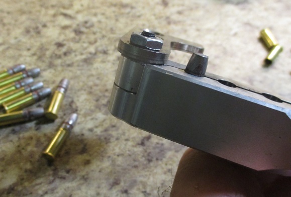

CRIMPING
I found if I did not have the cartridge in the crimp tool properly, when I crimped it pushed the bullet out of the case and I had to start all over again.

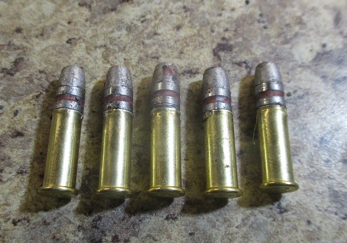

LOADED AMMO

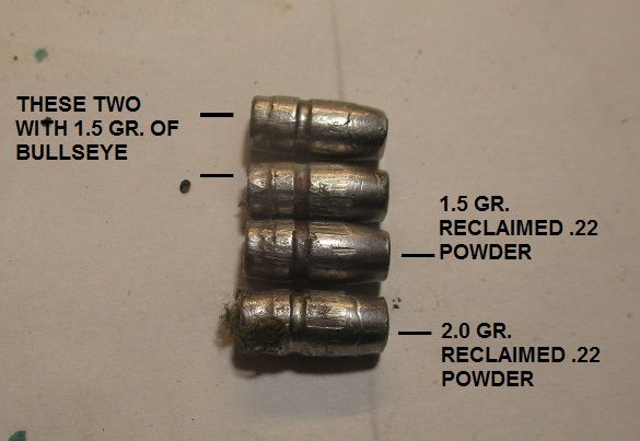

TEST FIRING
I fired loads into a pile of wadded up shop rags so I could recover the bullets. The first two shots were with 1.5 gr. Bullseye. The shot sounded about like a factory load.
I also loaded some with reclaimed powder from some .22's I had picked up on the range. The first was with 1.5 gr. and the second with 2.0 gr. of powder.
The load with 2.0 gr. was definitely hotter than any of the others.
The barrel and cylinder stayed clean. The next step will be to shoot them at 20 yards or so and check accuracy.
I notice that the two Bullseye loads do not
Wednesday, June 23, 2021, 11:42 (1965 days ago) @ Jim Taylor
have any evidence of engraving of the rifling. Maybe a bit more powder? I figure rimfire cases use faster powder than is available on the open market.
The idea of using gas check shanks for .22 RF heel bullets is fantastic. I was worried about OAL and throating until I saw the other results. I have a 43 (?) gr. mould and method to HP them. In RN form they did not impress me but with my swaged in HP they are truly impressive in the .218 BEE.
They engraved just fine. Going through 4 inches of wadded
Wednesday, June 23, 2021, 11:51 (1965 days ago) @ WB
up rags polished them, more on one side than the other.
Good data point. Pictures don’t always tell all.

In my TC- 22 LR 6.5" barrel , they engage the rifling hard
Sean Harper
Wednesday, June 23, 2021, 13:02 (1965 days ago) @ Jim Taylor
shoot good at 25 yards.
Sean
