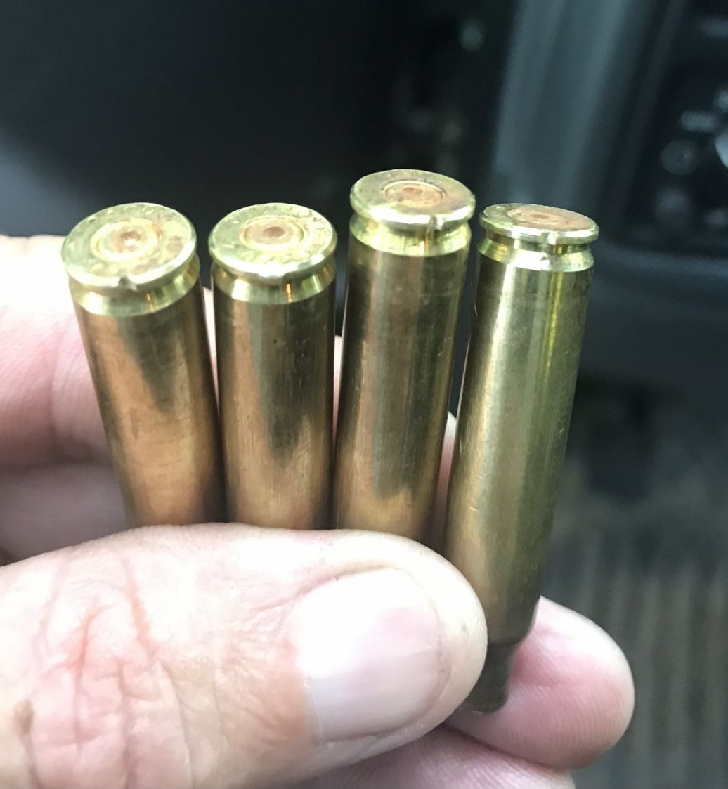

I am not real big on the AK platform but they are pretty simple and straightforward. the Galil is not all that modified but is made more sturdy. BTW I have several AKs.

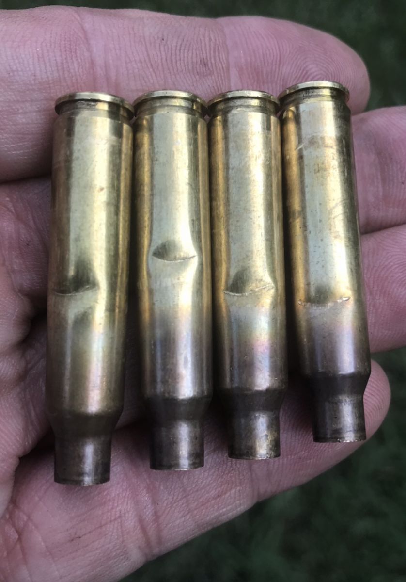

This one was stove-piping and jamming the next round up, every time. My examination turned up it was very, very, dry and dirty. The carbon was built up and rock hard. I can't remember seeing another gun that was actually dusty on the inside! A good cleaning and lubrication with the correct materials had it running fine. BUT an inherit trait is the rather rude treatment of brass the Galil seems to impart. The notch hammered into the cartridge base is from the ejector, a thin solid metal protrusion milled into the sturdy receiver. Also the side dents reveal the ferocity the ejection imparts on the spinning empties. They generally eject 6' and about 2-3 O'clock but every once in a while you'll get a 20 footer! I think you could kill a chicken with one of those. But generally speaking you can reload them a few times.
Overall it has some nice features and they seem to work well, they are serviceable. You could bludgeon someone with the sturdy mags.
