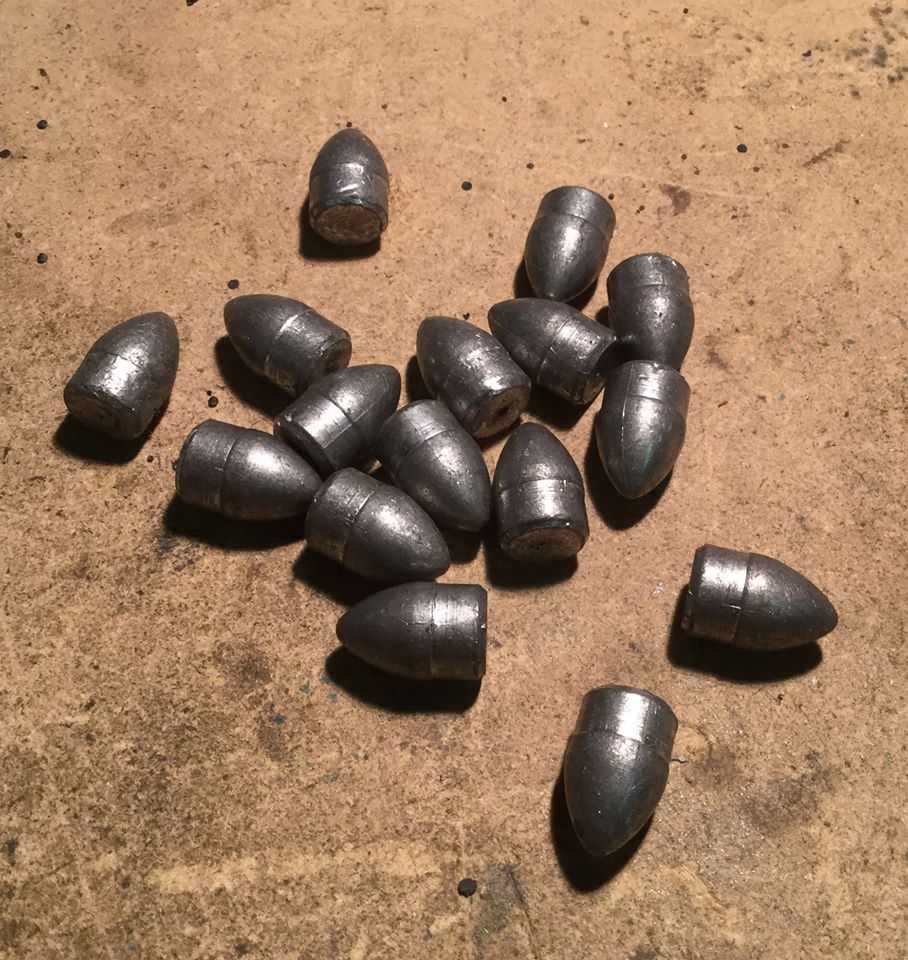

![[image]](images/uploaded/202107291910056102fd0d04c9d.jpg)

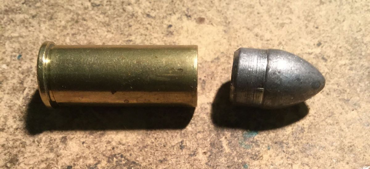

The 44 Heel Bullet
Using bullet 430185. This bullet was originally designed for the .44 Colt. It is an outside lubricated bullet. It is nominally 210 grains and has no lube grooves or crimp groove. The heel is .430" and the bullet body is .441". The oversize front part of the bullet acts as a crimp. It butts against the "step" in the chamber when it is loaded in the gun and holds the bullet back for a micro-second, allowing the powder to burn properly. It is completely sized by the chamber before it enters the barrel.

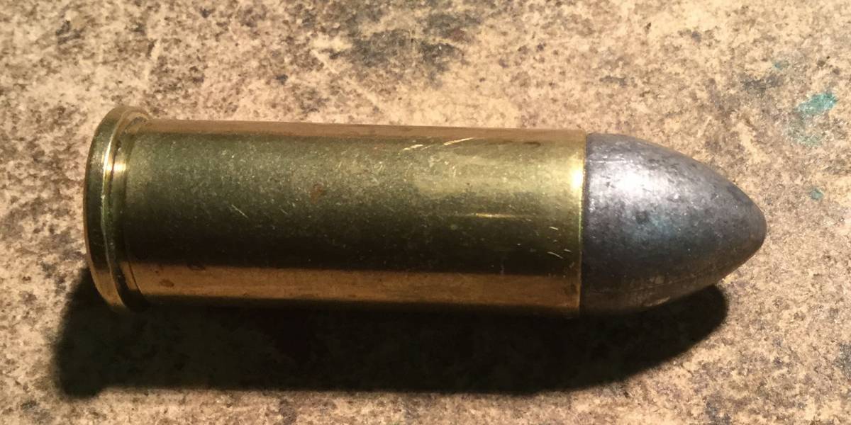

For .44 Special guns you will need to shorten the brass slightly or use .44 Russian brass. For .44 Magnums the .44 Special brass can be used.
1. Deprime
2. Prime
3. Add powder charge
4. Seat the bullet by hand .. thumb pressure .. pushing it into the cartridge until it stops.
Bullet can be lubed with Lee Liquid Alox beforehand or grease can be smeared lightly on it just before chambering it.
It's ready to shoot!
Once you fire it, pop the cartridge out of the gun and do steps 1 through 4 again and it will be ready to shoot. No sizing, no crimping.
Brass will last indefinitely.

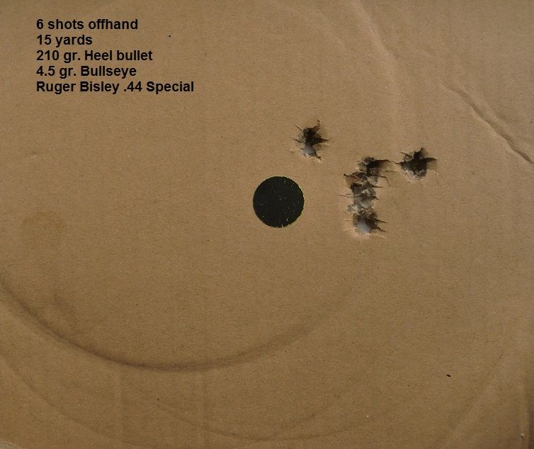

These are for practice loads only. Recommended velocity is under 900 fps. With 4.5 gr. Bullseye from my 51/2" .44 Special velocity averaged 760 fps

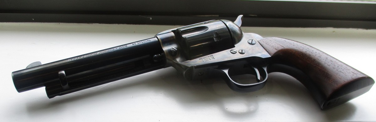

![[image]](images/uploaded/202107291913126102fdc8106bd.jpg)
![[image]](images/uploaded/202107291913256102fdd5dad7e.jpg)
![[image]](images/uploaded/202107291913416102fde54d300.jpg)

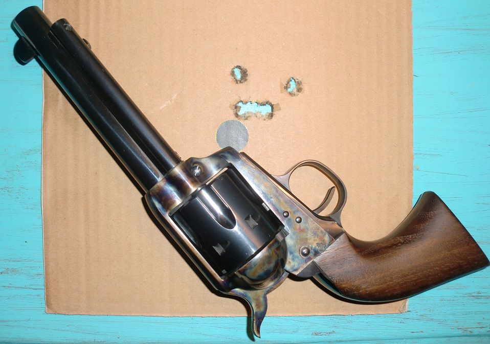

My USFA .44 Special will accept .44 Special brass loaded this way, but if the lube builds up the last 32nd of an inch can be hard to seat.

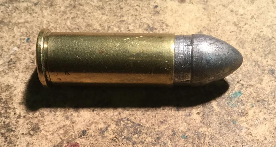

![[image]](images/uploaded/202107291915336102fe5502ef6.jpg)
![[image]](images/uploaded/202107291916026102fe727bd49.jpg)
![[image]](images/uploaded/202107291916206102fe84b2d64.jpg)

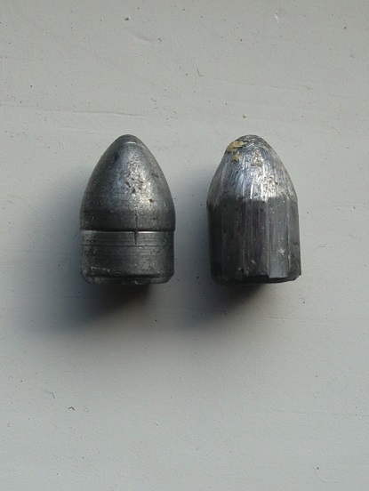

Unfired and Fired bullet

Shooting the .44 Special using the .44 Colt Bullet

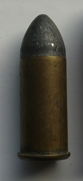

Very interesting. I have a box of late commercial ammo
- WB, 2021-07-29, 12:53
DON'T PULL;JUST MEASURE (nm)
- JT, 2021-07-29, 13:04
- Wondering if it's a hollow base. I'll check. (nm) - WB, 2021-07-29, 13:21
