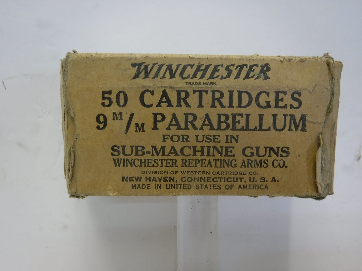

There was some "machine gun" 9mm ammo out there that was probably a bit hotter than regular 9mm but I would bet it was maybe +P level and for sure not +P+ level. I have read in some magazine articles that there was never any "Machine gun" ammo made but I beg to differ.
Sub-machine gun ammo (9mm)
backroadsrambler
Tuesday, August 10, 2021, 16:52 (1917 days ago) @ Gary Reeder
In the late 90s or early 2000s I picked a box of Israeli Military ammo so marked. Local gun shop got it in with a shipment of ammo, nothing they'd ordered, it just showed up.
Turned out to be +hot+. Thank God I fed it to the only Glock I owned. It snorted and jerked and tried to fly out of my hands!
Went back to the store but it was all gone and they couldn't order more. In fact, their source said they didn't know what they were talking about. But it sure as hell exists! (The only official +P+ ammo I ever saw and fired was LE-only for the FHP (Florida Highway Patrol). It was a 125gr. load for the department issue Colt Pythons! Damn flame-throwers but accurate and controllable once you'd accustomed yourself. They had an armorer who did a roller-bearing action job on their Pythons. Incredible double-actions!! Walt Sherman, up Tallahassee-way.)
