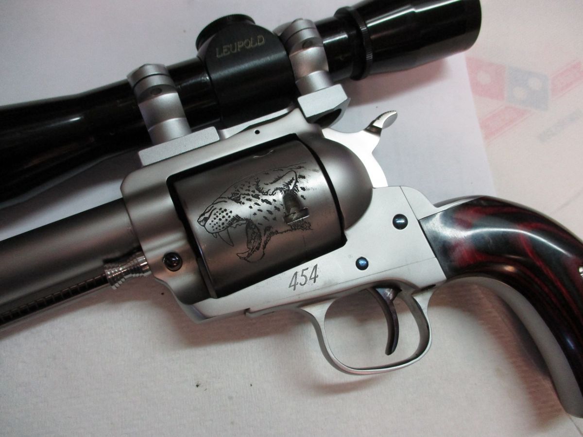

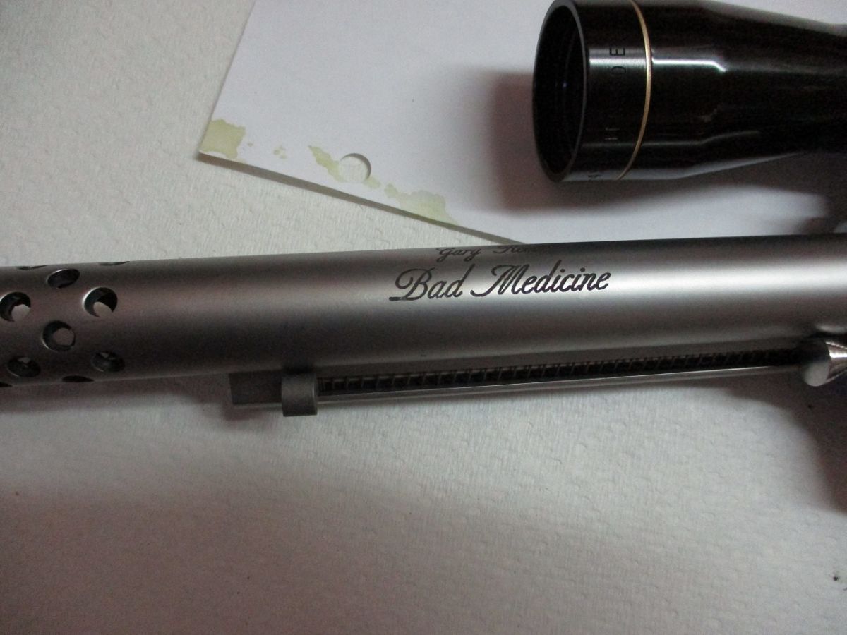

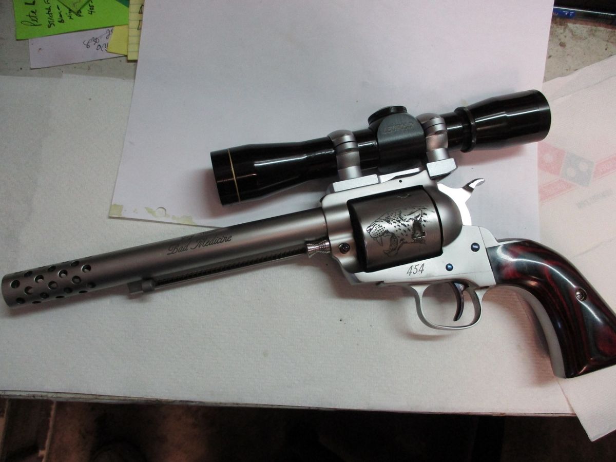

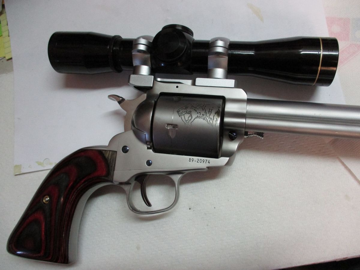

To make the South African requirements for this hunt I had completely built a new gun considerably different from any of my other revolvers.
![[image]](images/uploaded/2021082722572061296dd0dba0c.jpg)
![[image]](images/uploaded/2021082722574761296deba65a2.jpg)
![[image]](images/uploaded/2021082722580961296e01ebb1f.jpg)
![[image]](images/uploaded/2021082722582961296e153bf1b.jpg)
In the conversion we built a new 8" ported barrel (as 8" is the requirement for a hunting revolver), new cylinder with tight tolerances, exchanged my normal Bisley Gunfighter Grip for one of my Magnum gripframes with new red and black laminated grips. Refinished the gun with a satin Vapor Honed stainless finish with fire blue small parts, giving it sorta a red, white and blue look. We drilled and tapped the frame and added a Leupold base and rings with a 4X Leupold scope. To make it comply with my customs form I gave it a new name. It is now a Bad Medicine. But it is listed on my customs form as 454 Casull. That is because the South African registry has the 454 listed but not my 429. When we get back I plan on changing the gun's caliber shown on the gun back to 429 GNR. The gun is unusual as I don't have a gun with these features so I may leave it as is except for the caliber markings which will be shown as 429 GNR.
But in all this new conversion I didn't change the internals except for those necessary for a 5 shot conversion and the hammer spring that I lightened so that was my screw up. That lighter hammer fall wasn't 100% reliable.
To rectify this I took all the springs out and replaced them with new springs and one of the new heavy factory hammer springs. This should give the hammer fall that heavy factory slam which should set off even any of those small primers. I haven't loaded my hunting ammo for this gun for the hunt yet as that is this weekend's work. For that I will make sure and use the newest box of small pistol magnum primers I have. I am hoping this will solve any unexpected problems but I will run another 25 or so rounds thru it in the next 2 weeks and hope old Murphy is off bothering someone else.
