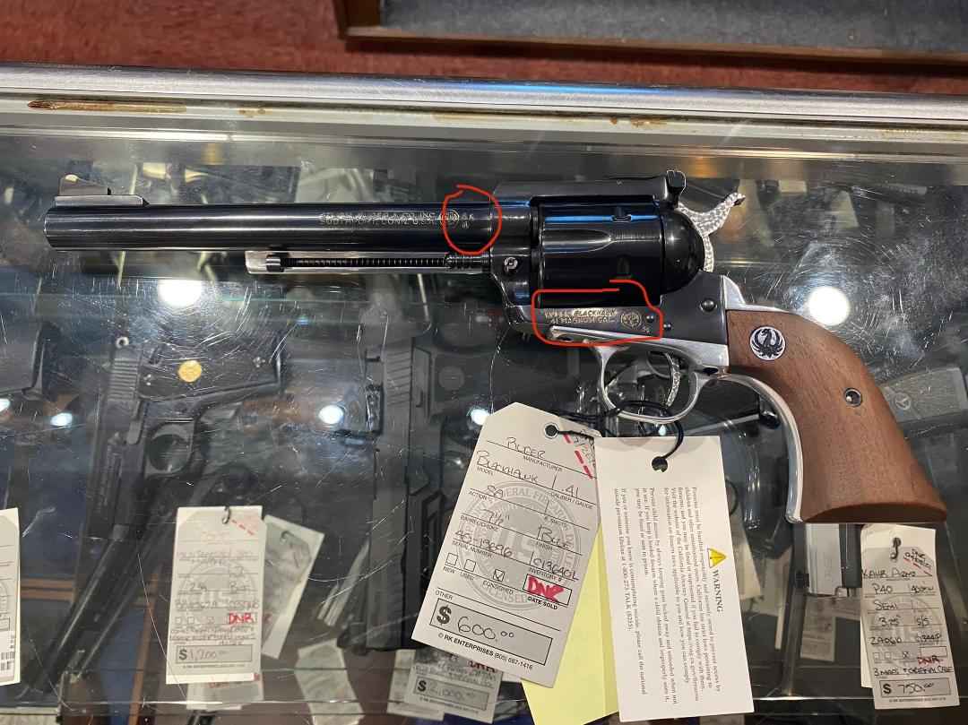

Hard to see in the photo my nephew sent me. His buddy found this in a gun shop in California. Barrel marked .44 .. frame marked .41 ... and his friend checked it and it is apparently a .44-40!
No signs of who did the work on the gun. Been reblued. You can see the jeweling on the hammer and trigger.
two of us looked at it under a glass and we can't see

where you say it says 44 magnum. I have never seen Ruger put the caliber on the left side of the barrel like that. we looked at several old model take off barrels here in the shop and in that spot there is the Ruger logo and the proof mark. Can you take a take a better pic of just the barrel marking and maybe we can see what you are seeing.

He sent the picture from California ..
Wednesday, September 08, 2021, 15:02 (1888 days ago) @ Gary Reeder
I couldn't see the .44 either.
