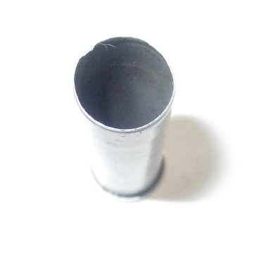

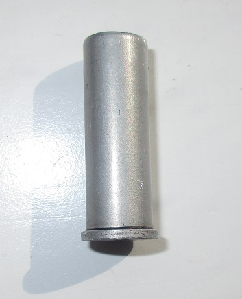

I spent a little time this morning loading and shooting a non-reloadable Blazer .38 Special. It has been reloaded and fired more than a few times and still is going strong.
I did this to jack up Waterboy and get him experimenting again ... and I did this just because I can.

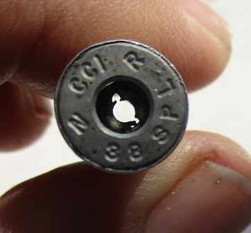

You have to punch out the Berdan primer and make a central flash hole. Easy with an aluminum case.
I only full length sized this case once. All the loads have been light .. 2 or 2.5 gr. Bullseye.
I think it's gonna crack soon ... look at about the 10 o'clock position on the case mouth .. it's getting thin there.

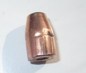

I have been shooting 9mm bullets from this case.
I caught this one in my bullet catcher.

5 reloads .. 2 neck cracks after the 5th reload.
