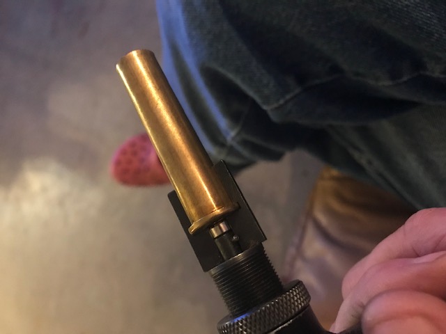

So I figured out what that little washer "adapter die" does
Tuesday, October 19, 2021, 13:37 (1847 days ago)
on a Lyman 310 tool. It ensures concentricity of the case with the die. This does things such as prevent breaking de-capping pins etc. (ask me how I figured that out) The handles can push on the bottom of long cases at an angle. If the case is not supported it indeed is at an angle starting into the die body and may be misaligned. With care it can be deliberately overcome but the adapter die part does serve a purpose.

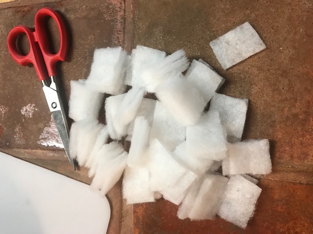

Using slower pistol powder for cast applications I broke out the 1/4' thick Dacron blanket stuffing. As directed by the manual. One benefit is after application (stuffing it against the powder with a pen) is that it cannot spill.
I have had this package of stuffing for over a decade (not even close to making a dent as yet) and also used it in .303, .30/40, .30-06, .470/500 Nitro etc. as well as varied Reeder GNR's for light loads or fireforming. Tissue or paper will catch fire! Dacron is good stuff that works while adding no notable weight to the projectile or charge and does not melt nor combust, it just blows out. Even with a chamber break it just blows out the holes. These squares will likely be cut in half again.

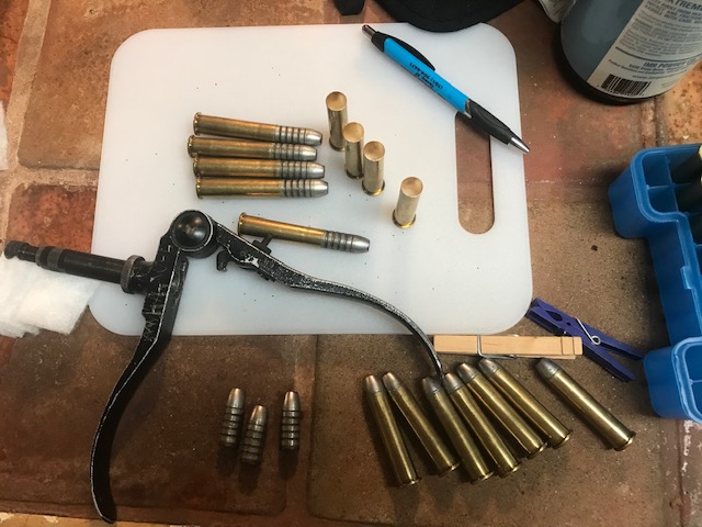

I have always enjoyed the #310 priming system. Its fun.
Follow up: the .45-70 load using H4227
Tuesday, October 19, 2021, 17:07 (1846 days ago) @ WB
As listed in an ancient Lyman manual from mid-last century, 20 grs. W/filler wad (Dacron stuffing square) and a nominal 500 gr. bullet (512 gr. actually) was spot on running right at 1025-1030 fps from the 29” barrel. It grouped well but to the left, and my set trigger stopped working (?!).
Seems like a great low pressure load with power right where I needed it. Faster speeds (1200-1400 fps) will need more of a slower (med.-rate) rifle powder. H322, IMR3031 etc. H4227 is too fast for much faster speeds with that big bullet.

for my contender 16" barrel i've been using 30-33 grains of 3031 with eather a340 or a 405 cast bullet and a small square of dacron wadding the 340s with 33 grains go 1250fps and the 405 with 33 grains go 1100+ fps. recoil isnt that bad i can shoot about 10 rounds in 1 session before i call it quits. the 30 grains loads are almost mild .i've tried 34 grains and recoil in that light 16" carbine is starting to get snappy
