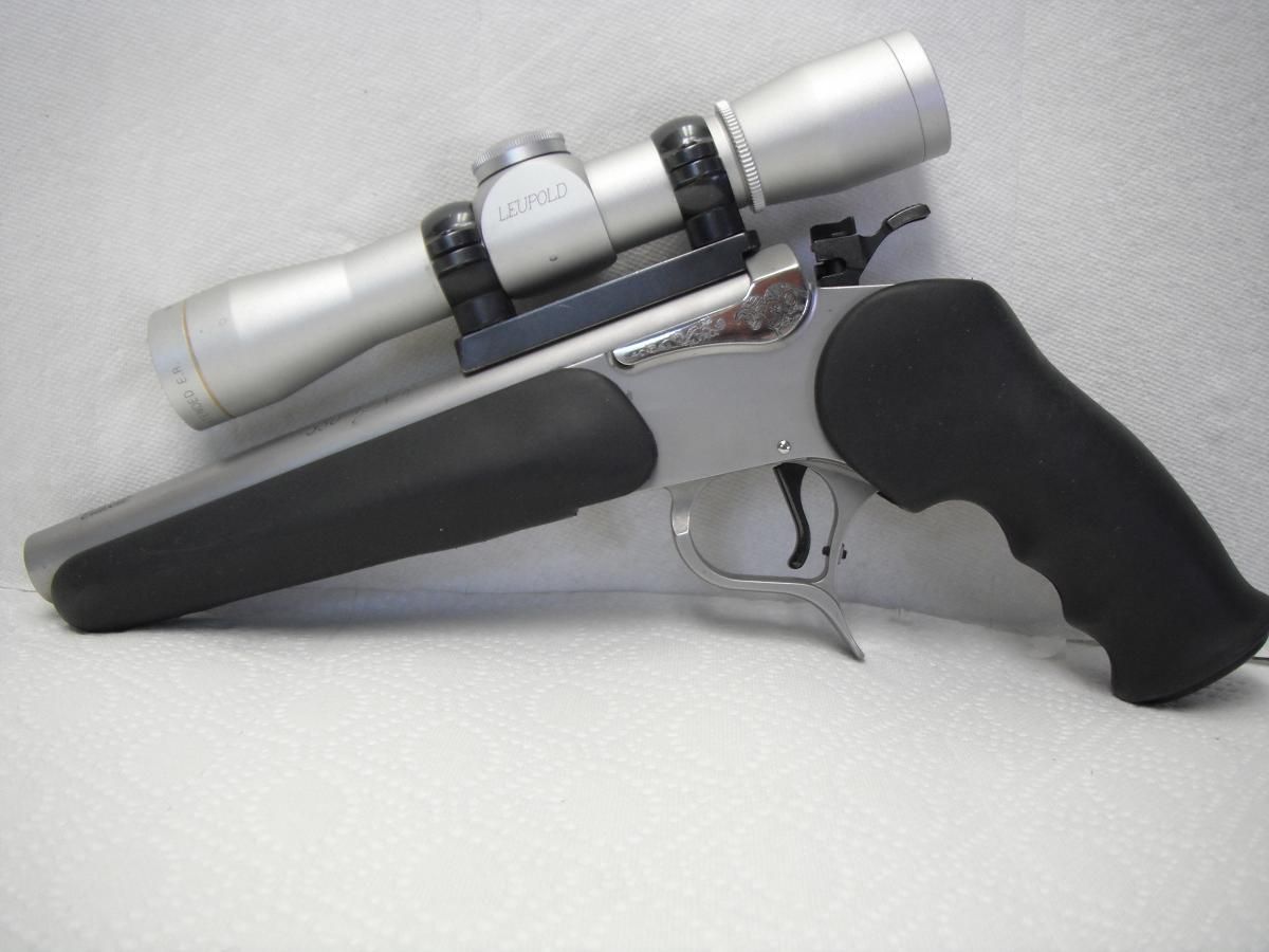

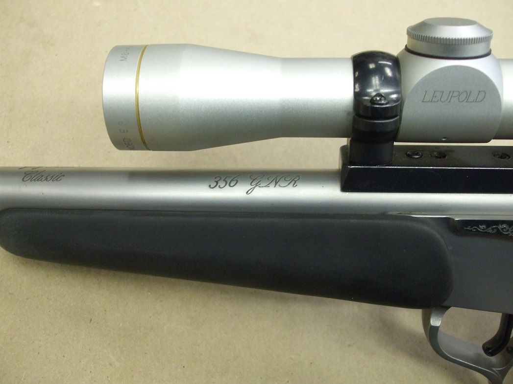

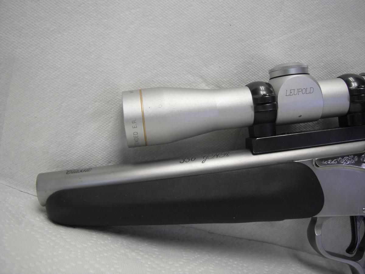

I shot a 500 lb Nilgai with my little 9" G2 in 356 GNR
Saturday, November 06, 2021, 11:28 (1829 days ago) @ Alcorn
