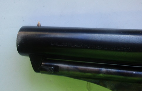

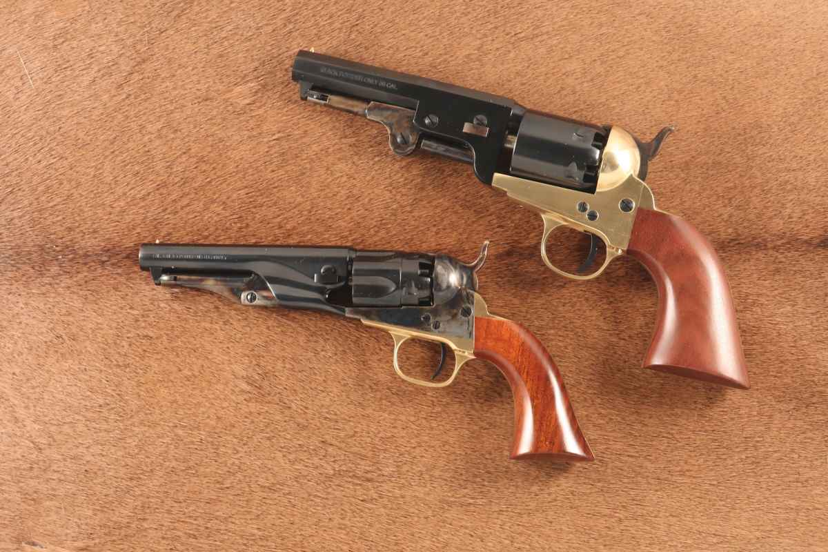

I first loaded it with light loads of Pyrodex P and of course it shot high. I mean, with the little bitty bead on the on the barrel I figured it would.
![[image]](images/uploaded/2021110721325561884607ddee0.jpg)

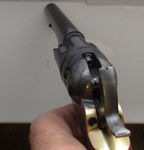

Shooting full power loads with Pyrodex P and with 3Fg Black Powder, it still shot high as I figured it would.

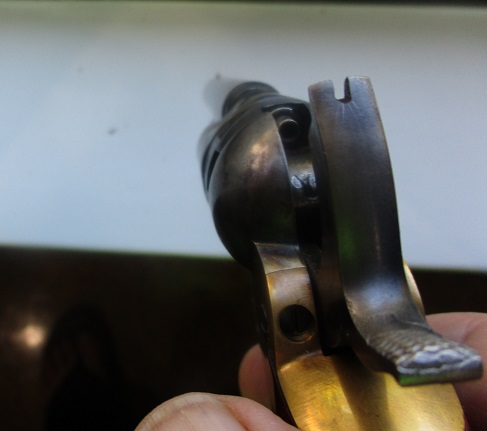

I took a small jeweler's file and cut the rear sight notch in the hammer deeper.
BEFORE
![[image]](images/uploaded/2021110721350261884686d2de2.jpg)
AFTER
![[image]](images/uploaded/20211107213534618846a692013.jpg)
I drop the bead to the bottom of the notch and hold 6 o'clock on the 8" 15 yard gong and it's "ON" every shot.
I need to put it on paper to see exactly where it's hitting but it's a lot closer now. I figure to get it on at 50 feet I am going to have to cut it some deeper.

Sunday, November 07, 2021, 15:10 (1828 days ago) @ Jim Taylor
Since it's a pocket gun I figured about 25 ft. was a good regulation goal. I've not put it on paper either. Not sure I even scared the 20 yd. gong. But it was made more for just outside of knife range for it's day. The .31 ball is lots more formidable than the .22! I plan on testing that some.
It is functioning well, the caps stayed on the nipples but were split for easy removal. No jams and only one fail to shoot after I noted I did not fully seat the cap on a nipple, robbing it of proper ignition. The second cap lit off fine. That was in three or four cylinder loads. This C&B would relate to a more modern .32 pocket revolver.
That .36 Police relates to the modern .38 Special 3-4" Police gun of mid-last century. We both know a well armed fellow would need AT LEAST a brace of them. A BIG knife is not a bad addition either.

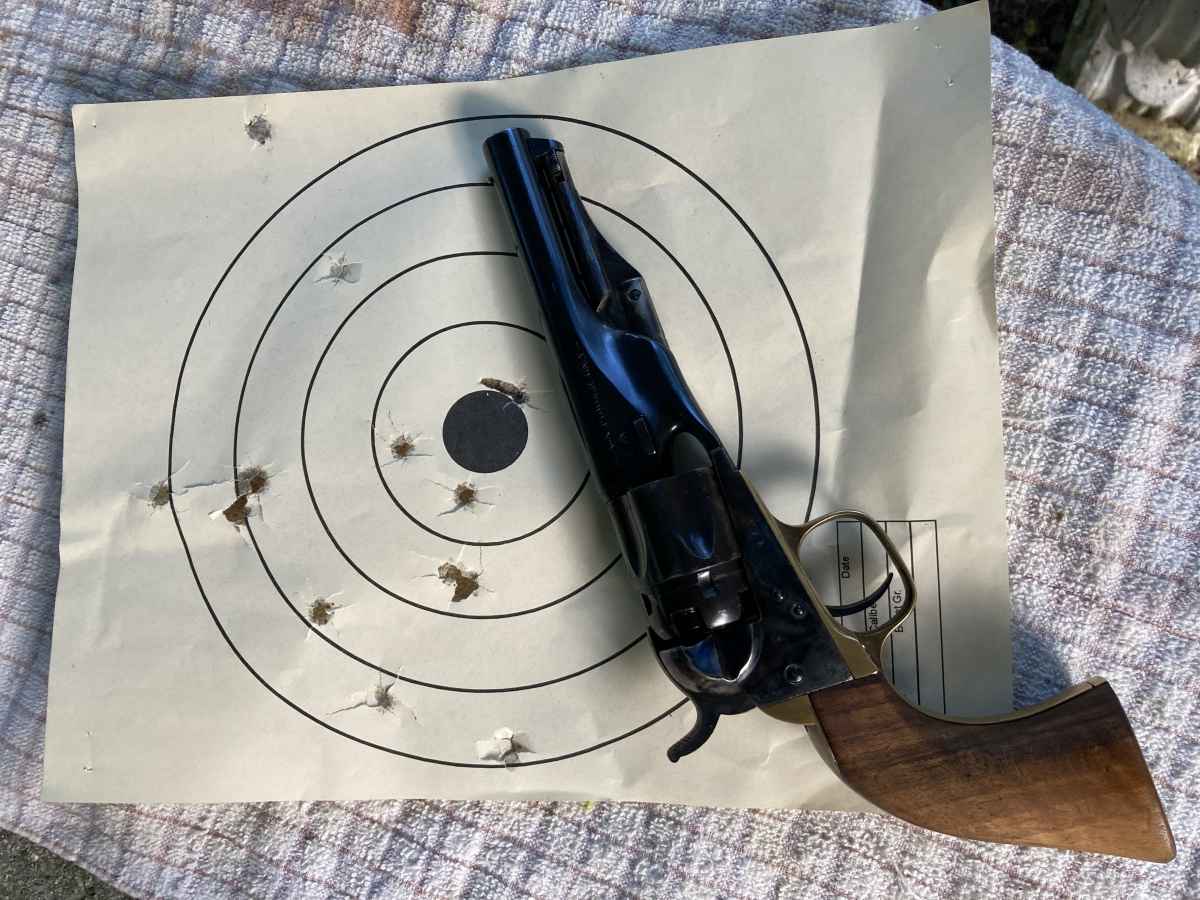

Sunday, November 07, 2021, 18:44 (1827 days ago) @ Pete
For this target I ended up aiming at the bottom of the target frame ![[image]](images/uploaded/20211108014339618880cb8caed.jpg)

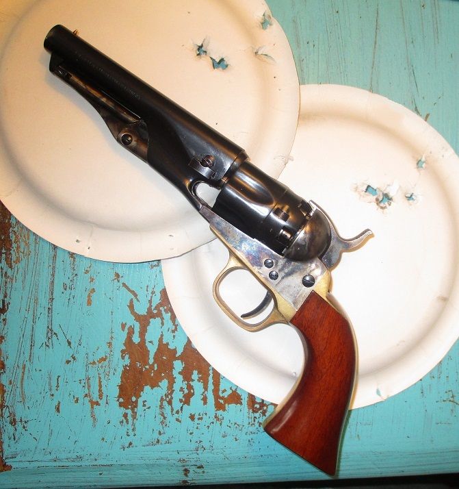

Sunday, November 07, 2021, 21:07 (1827 days ago) @ Pete
Mine hit about a foot high at 50 feet.

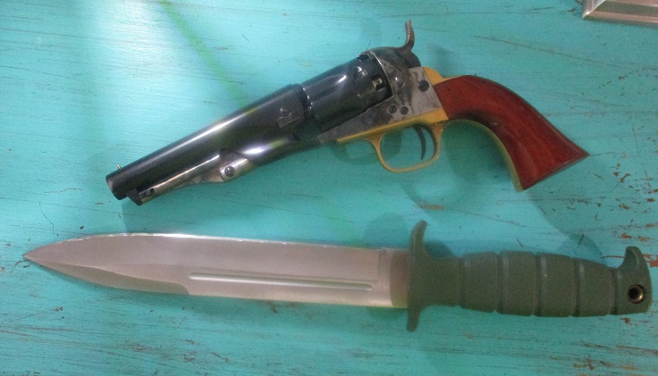

My latest knife goes well with the .36. I haven’t made a sheath yet. ![[image]](images/uploaded/202111090322566189e99078174.jpg)
