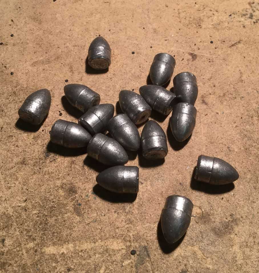

![[image]](images/uploaded/2022013003061161f600a38897d.jpg)
BULLETS

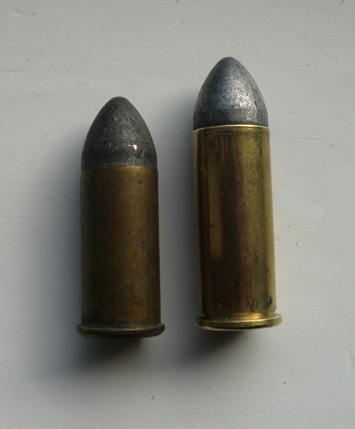

![[image]](images/uploaded/2022013003065861f600d2ba90c.jpg)

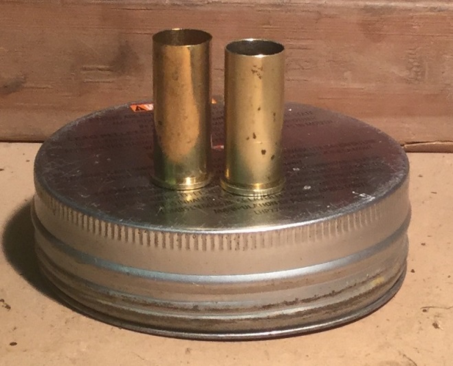

.44 Colt on the left .. one of my special .44 Specials on right.
![[image]](images/uploaded/2022013003080461f6011407eff.jpg)
Left .44 Special Right trimmed .44 Special

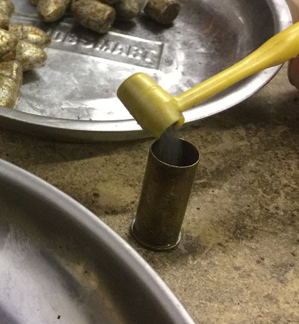

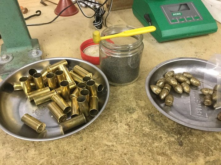

- add the powder to a primed case
![[image]](images/uploaded/2022013003090961f60155aeb8a.jpg)
![[image]](images/uploaded/2022013003095161f6017fb21de.jpg)

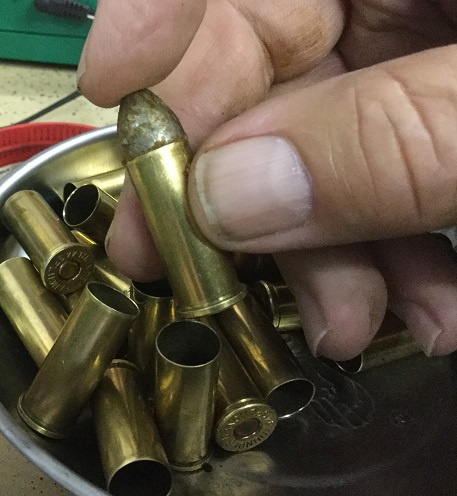

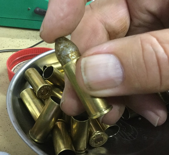

- seat the bullet with thumb pressure
![[image]](images/uploaded/2022013003102961f601a500b65.jpg)
![[image]](images/uploaded/2022013003104961f601b910134.jpg)

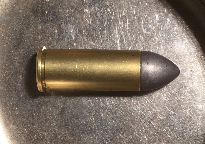

It's ready to fire.
