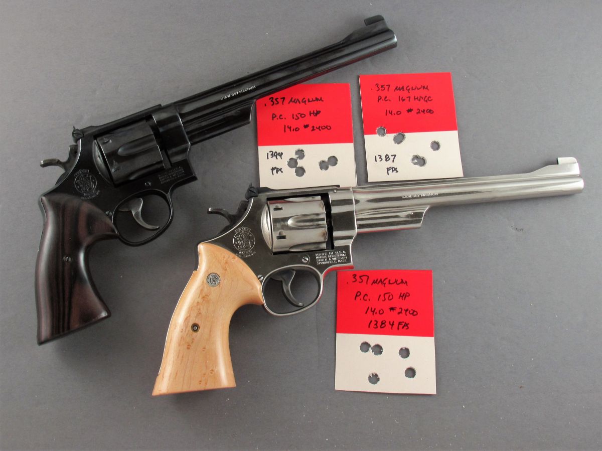

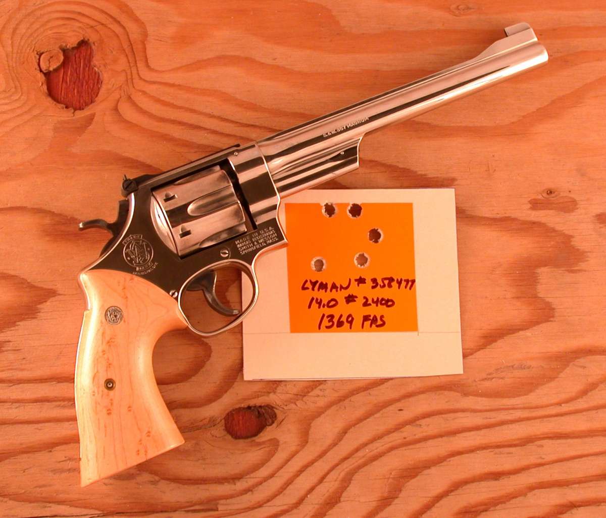

Looking back through some of my load data when I first started powder coating, I'm showing a slight increase in velocity with coated bullets verses traditional lube. This was 10mm ammo and the difference wasn't enough for a sight adjustment.
