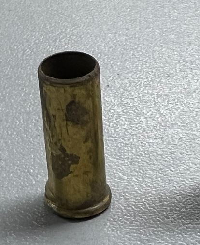

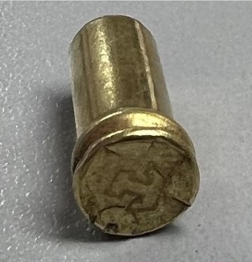

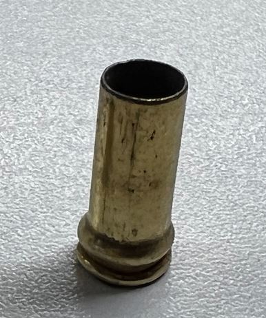

Not by me. A friend who works a shooting range in New Mexico found these the other day.
![[image]](images/uploaded/202202241541456217a739abb91.jpg)
![[image]](images/uploaded/202202241542086217a75062782.jpg)
The two top photos are the same cartridge. The one below is a second one he found.
![[image]](images/uploaded/202202241542236217a75fa43ea.jpg)
Looks like the chamber was not supported or
Thursday, February 24, 2022, 10:32 (1719 days ago) @ Jim Taylor
Breach fully closed when that went off. Could have fired it in a .22 WMR chamber too. I do that on occasion, they shoot ok actually. Sometimes brass splits. But for emergency…

Thursday, February 24, 2022, 10:34 (1719 days ago) @ WB
never had one that looked like that. Looks to me like the it fired out of battery for some reason.

Thursday, February 24, 2022, 12:52 (1718 days ago) @ Jim Taylor
dirt and residue holding the breach open a little bit or perhaps a very weak recoil spring allowed the bolt to open a smidge premature, with pressure still high.
I've read that some early Colt .22's did NOT have recessed rimfire chambers and they cautioned against hi-speed .22 ammo. Now days most rimfire revolvers still have recessed chambers. I guess not too bad an idea on any rimfire. Centerfires with recessed chambers (like my M27 S&W) make me remember back in the day they had balloon case head brass. I guess they could let go under the right circumstances.
