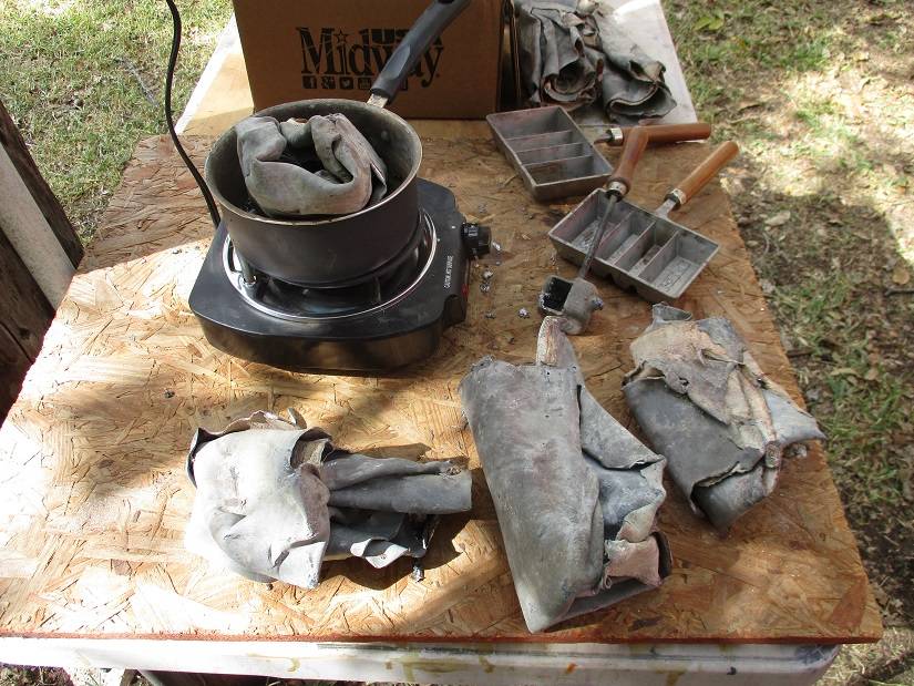

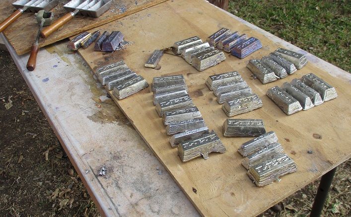

Those who remodel old homes find lead shower pans ..
Monday, February 28, 2022, 20:46 (1714 days ago) @ MTM
under the tile of the shower. I was given one last year and got over 70 pounds of lead ingots from it.
