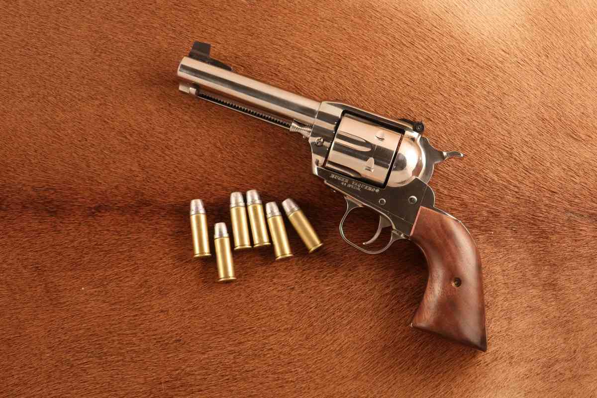

John, is that a converted Vaquero? Looks like some we do.
Tuesday, March 01, 2022, 14:04 (1713 days ago) @ JT
MILT MORRISON INSTALLED S&W rear sight,
Tuesday, March 01, 2022, 15:57 (1713 days ago) @ Gary Reeder
Garza Front sight. I added Super B hammer, Belt Mtn Base pin and Tony Kojis made the mesquite grips. Here is the copmanion .44 Special
I like that!
Amede
Tuesday, March 01, 2022, 19:00 (1713 days ago) @ JT
It looks like a pre-war custom SAA!

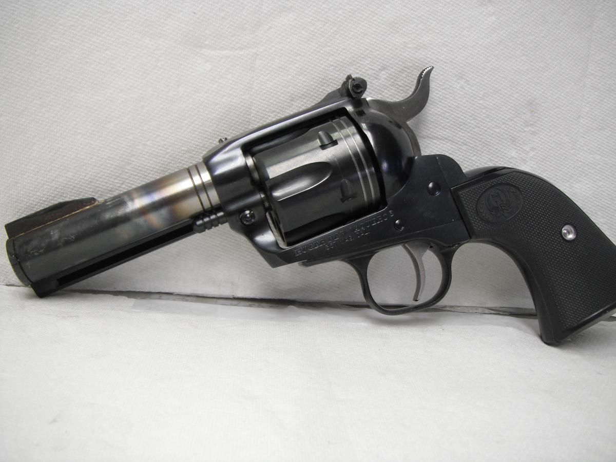

Wednesday, March 02, 2022, 13:05 (1712 days ago) @ Amede

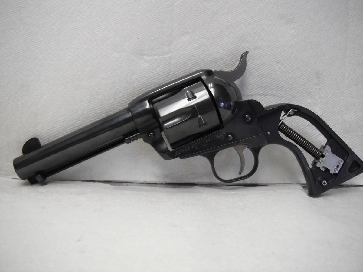

here is one we did a while back
Wednesday, March 02, 2022, 16:25 (1712 days ago) @ JT

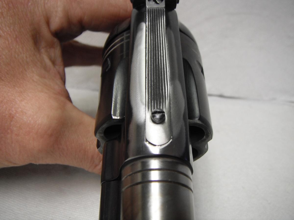

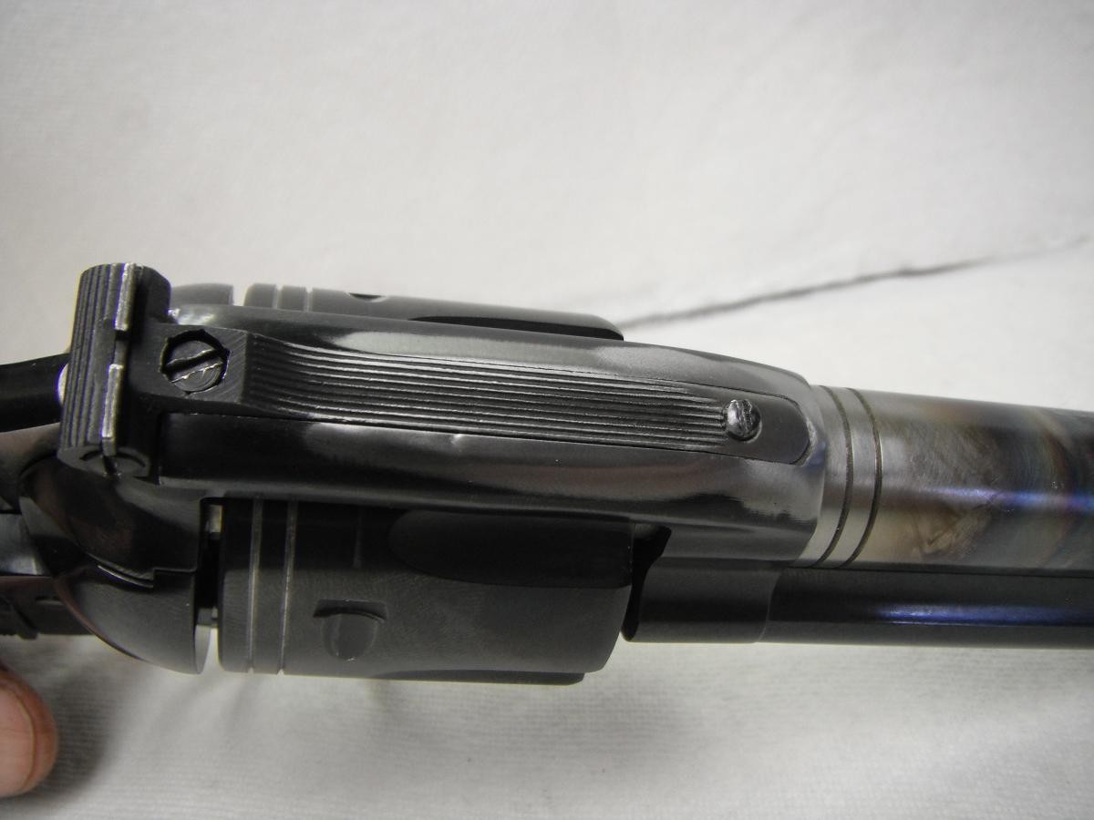

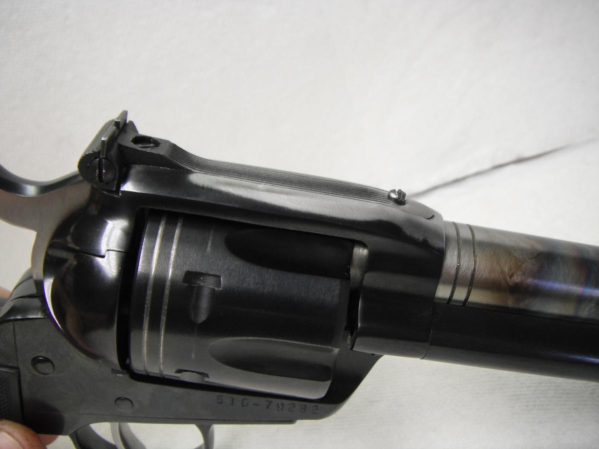

the Vaquero to start with

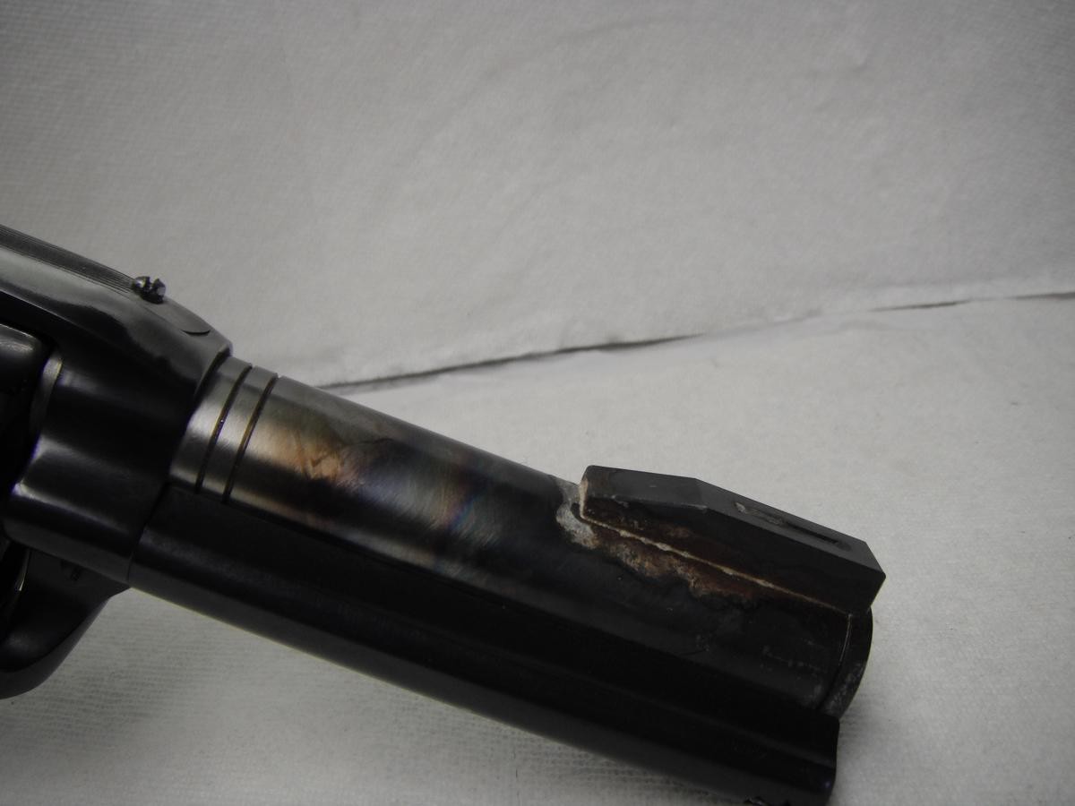

widened the groove down the top strap and fit the S&W sight to it.
tapered the top of the frame to fit the sides of the rear sight.
The small screw in front was just there to hold the sight in while we tapered the frame.
we cut the 2 gold bands on the barrel and the cylinders and soldered on the interchangeable blade front sight.
From there it went to the normal buffing and polishing before going to the bluing tank.

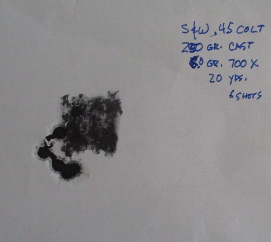

255 gr. RNFP & 6 gr. 700X
Tuesday, March 01, 2022, 13:42 (1713 days ago) @ Jim Taylor
I shot this group with the S&W 625 Classic .45 Colt.
MILD & ACCURATE!
