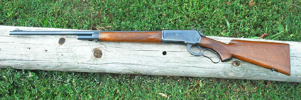

The Model 71 Winchester was the culmination of the large-frame leverguns produced by the famed old company. Introduced in 1936 it was an upgrade of the famous Model 1886. Designed to make manufacturing a bit easier with improvements to handle the new cartridge that was introduced with it, this was the last of the big-frame leverguns made by Winchester.
The Model 1886 was designed during the black powder era for large black powder cartridges. Chambered for a variety of calibers including the .45-70, the Model 1886, was adapted to a new smokeless powder medium bore cartridge called the .33 WCF in 1902. The .33 Winchester was intended for hunting large North American game and used .338" diameter bullets, the same size used in today's .338 Magnums. However, by the 1930's the .33 WCF was looking a bit underpowered. That and the increased costs for the production of the 1886 (along with the slowdown of the economy) had Winchester looking around at ways to cut costs in the production of the big leveraction.
THE RIFLE
A redesign of many of the internal parts along with the introduction of a new caliber was Winchester's plan to get the costs down and to market the package. The redesigned '86 was renamed the Model 71 and the rest, as they say, is history. The rifle was produced in only one caliber .. the .348 WCF .. and it is the only factory rifle ever chambered for this round.
It was introduced in two different models, the Standard and the Deluxe versions and was produced in 2 barrel lengths, 20" and 24" (carbine & rifle). Both models used a pistol-grip stock. The Deluxe version had checkering on the forend and stock, along with snap-on sling swivels, pistol-grip cap and a really cool bolt mounted aperture sight.
By the mid-1950's with costs again rising, the Model 71 was discontinued. The rifle was pretty expensive to produce. Too expensive to build and still make a profit. In 1956 Winchester stopped it's production and the last big levergun was no more. About 47,000 of the Model 71's were made during it's 20 year history.
In 1987 Browning produced a modern version of the Model 71 that was made in Japan. These have different thread sizes in places, most notably the barrels, and many parts will not interchange with the originals. The Browning version was a limited production model only.

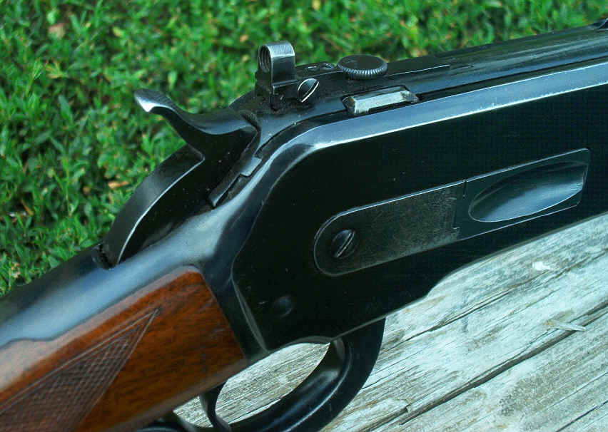

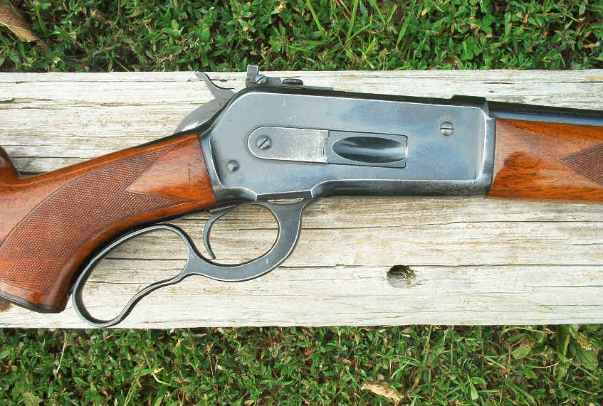

Bettter photo of rifle and the rear sight
Monday, March 21, 2022, 07:31 (1694 days ago) @ Jim Taylor
That's a pretty gun! Prices have skyrocketed
Monday, March 21, 2022, 08:03 (1694 days ago) @ Jim Taylor
most are north of $2500 now. I know a guy who used one for Elk. He made a horrific mistake of leaving it atop his car and driving off. At about 50 mph he looked up to see it slide off and bounce down the asphalt. It did not break anything but skinned it up badly. He is still sick about it decades later! LOL It hurt me just to hear!!!
That sight looks cool. Skinner has some good stuff that looks kind of like that. Does the knurled big knob remove the sight or adjust elevation?
Adjustment if I remember right- never tried to remove it.
