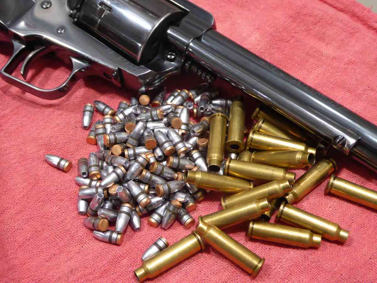

Cast, sized, and lubed a few of these today.
I've been shooting the Coyote Classic in 218 Mashburn Bee a little lately, and I was getting low on bullets.
This is a LBT-FN that was hollow pointed by Eric some years ago. Ready to shoot this bullet weighs 51 grs. and is sized to .225. Velocity is right around 1,900 fps.
A little bit of lead and a little bit of 4227 makes an enjoyable day.
Looks like some good Rock Chuck Theraphy is on the menu.

Good looking bullets!! Smallest I ever cast was .25 caliber.
Wednesday, March 23, 2022, 17:38 (1691 days ago) @ Mark Conner
Need to wear magnifiers and use tweezers to pick them up!
Yes, some finger dexterity is required.

Good lookin bullets, the 22 molds take a lot of
Sean Harper
Wednesday, March 23, 2022, 18:00 (1691 days ago) @ Mark Conner
Heat to warm up and cast good bullets. I have 3 -22 molds once the molds get hot they produce great bullets.

Yea I generally try to increase my pot temperature a bit and cast a little faster to keep mould temp. hotter.

I had some centerfire .22 handguns and was playing with cast. Namely the old Lyman round nose 48 gr. GC. It was basically a CF version of the nominal .22 RF 40gr. pill. Performance was lackluster, even at 2000 fps. Like shooting an ice pick.
I got a goofy idea to use the LEE .224 sizer die to hold the bullet centered and using a rod with a machined tip to slide down the middle of the die "cold forge" a HP cavity into the homely old bullets. Paco Kelley made that .22 RF tool that gave me the idea.
By golly it worked like a charm. The control was me custom cutting the rod to be flush with the die top (where I could not tap it deeper)at exactly the point I wanted it. It was too simple.
I used my .218 Bee rifle as a control. Running both RN and HP bullets at 2200 fps and shooting soap blocks as a consistency control it proved at least a doubling of energy transfer!
I didn't need a new $150 mould, only a 3" piece of brass 1/4 dowel.
