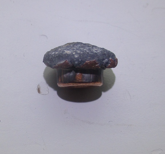

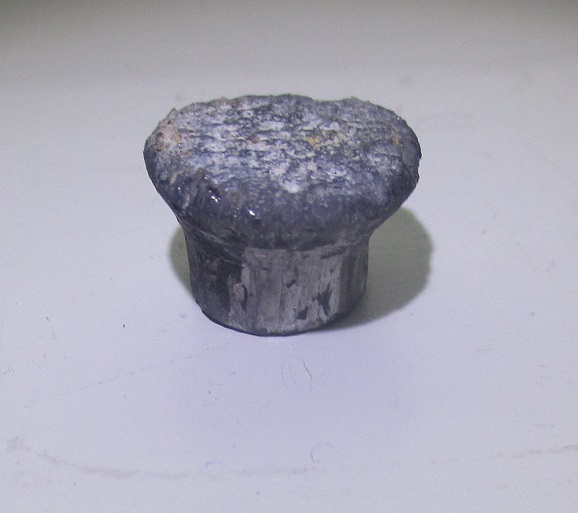

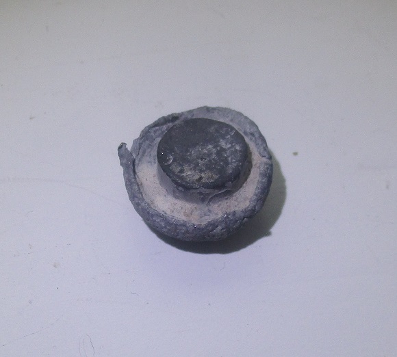

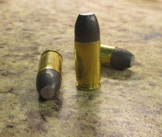

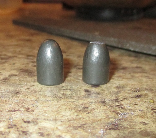

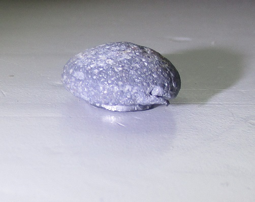

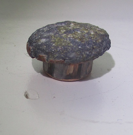

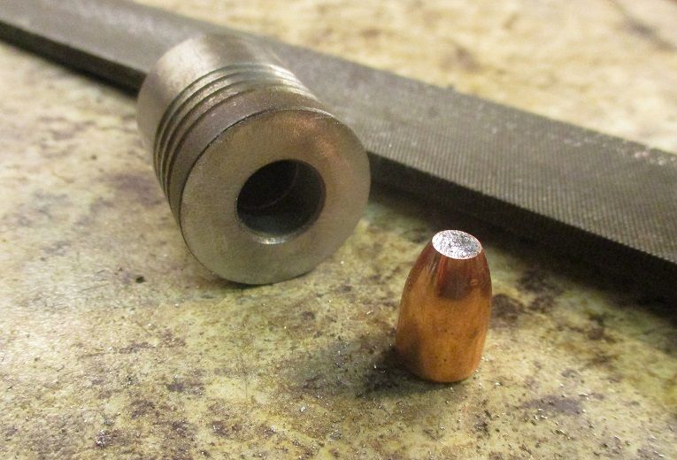

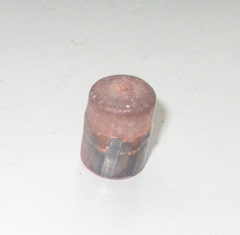

Using a Berry's Double Plated 124 gr. Round Nose bullet .. I made a tool to flat-nose them.
Loaded them over 5.8 gr. Unique and Small Pistol Primer
I fire an UNMODIFIED one into a bucket of sand.
It did not lose any weight .. penetrated about a foot into the sand.
Then I fired a MODIFIED one into the sand.
It did not lose any weight either.
So I decided to flat-nose the 125 gr. Bear Creek Supply bullet and shoot it into the sand.
An UNMODIFIED bullet was fired into the sand.
Then a MODIFIED bullet was fired.
The Bear Creek bullets did not lose any weight either.
This test does not have anything to do with how the bullets would perform in flesh. But if you are gonna shoot some sand, I have good data!
As long as that FN clears the ramp, I'm all in.

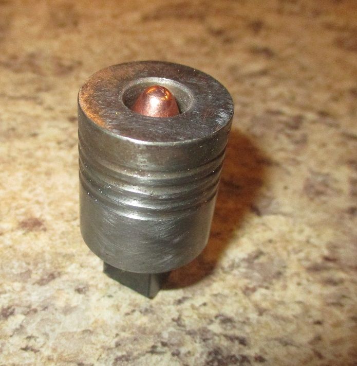

Can you give some details of your fixture? WaterBoy’s hollow point tool using a center drill to hollowpoint is a good one too

The “Flatnoser” that Jim made is a great idea, but probably takes a file to knock the tip off (a vertical mill would be nice, or a lathe with a collet chuck).

It's just part of an old die set for making gas checks...
Monday, April 11, 2022, 14:47 (1672 days ago) @ steve todd
for 38/357 caliber bullets. I don't have the rest of it and gave up making gas checks years ago. The 9mm bullets drop in with a nice fit. I made a plug to go into the bottom of the die and using "try and see if it fits" ground it to the proper length.
