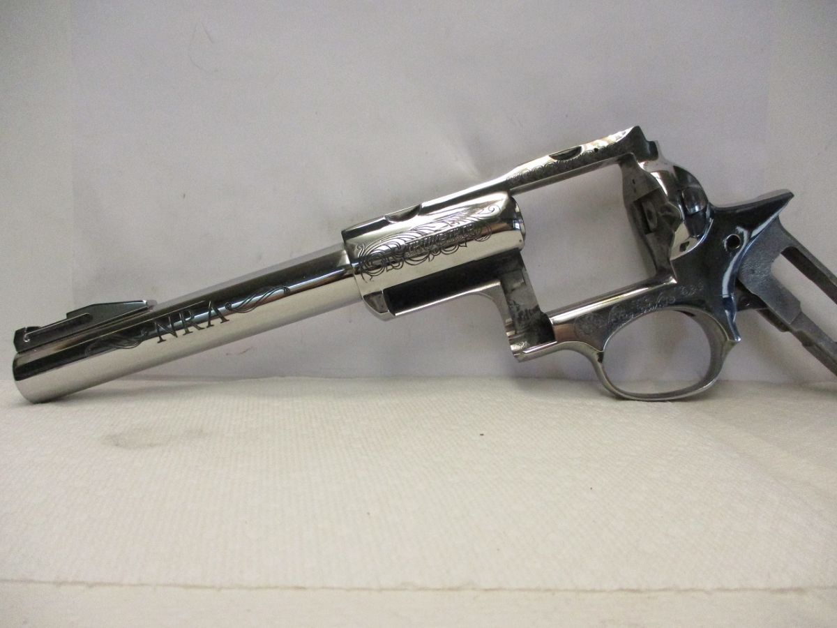

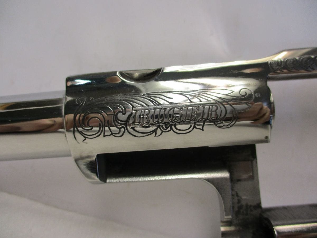

every year we try to customize a revolver for the NRA dinner
Saturday, April 23, 2022, 16:00 (1660 days ago)
They raffle it off or auction it off and it usually gets them 4 or 5 thousand dollars. The dinner is in a couple of weeks and we have been working on a custom Super Redhawk. Here is the gun so far, about 2/3 finished.

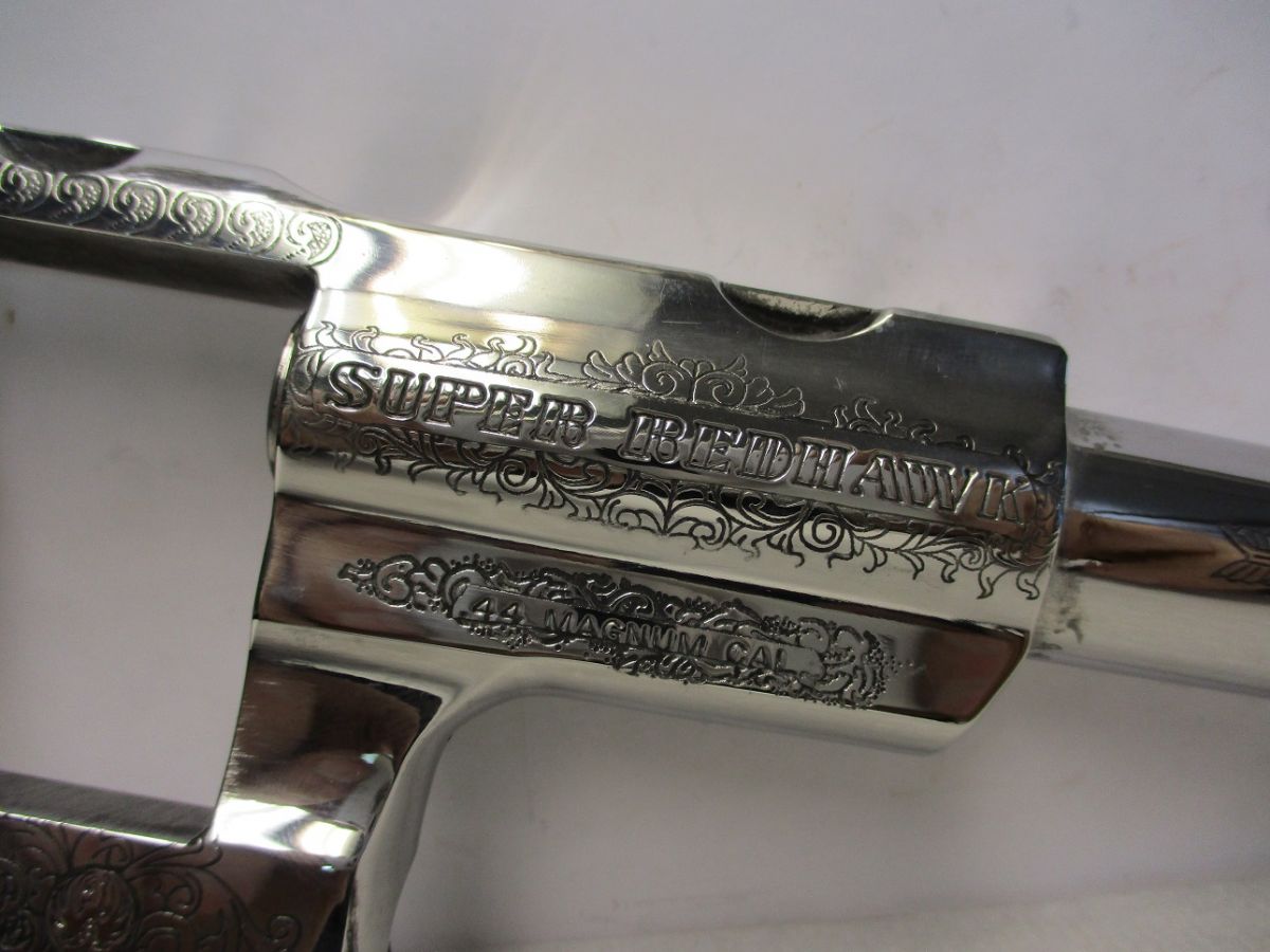

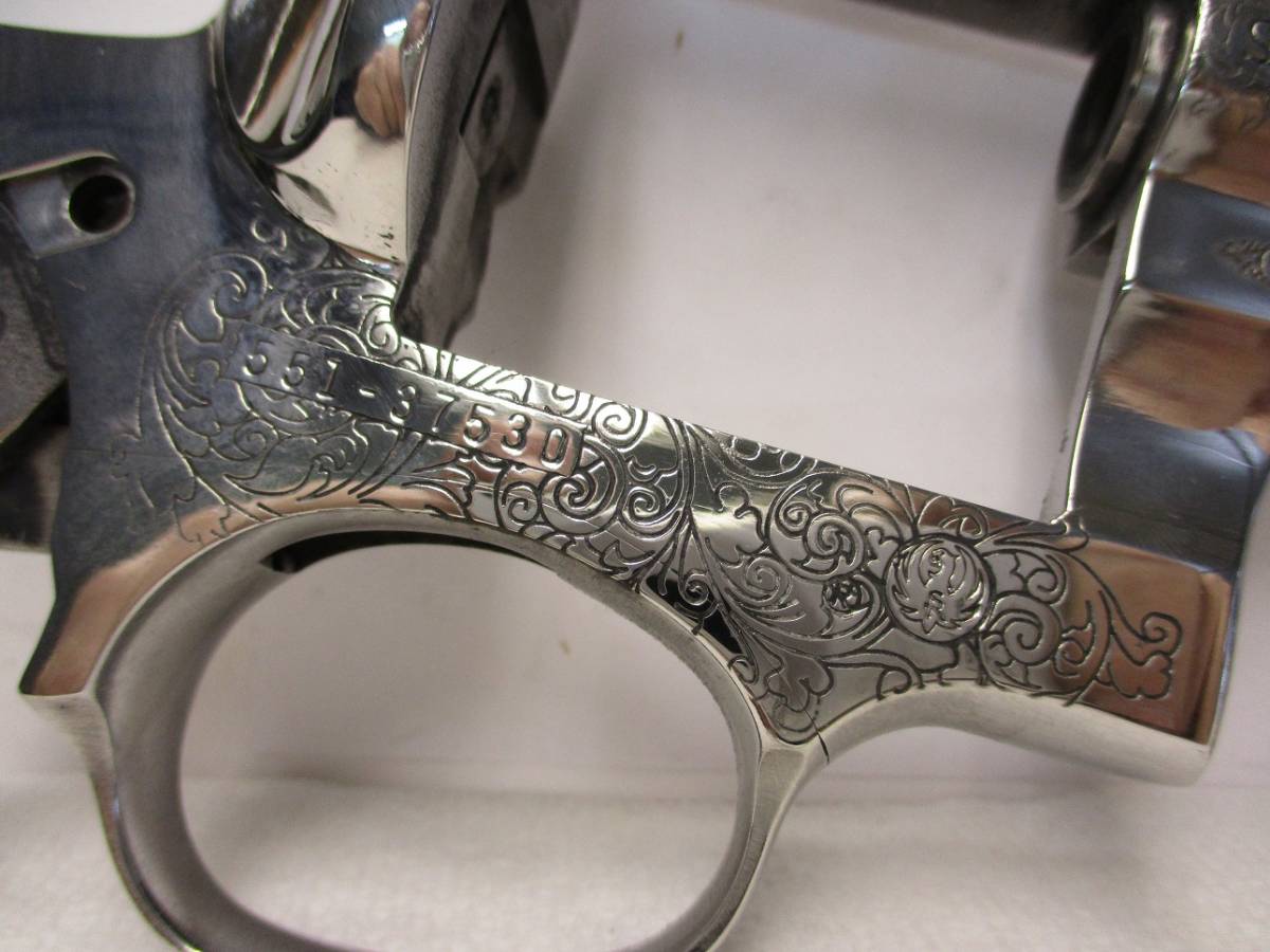

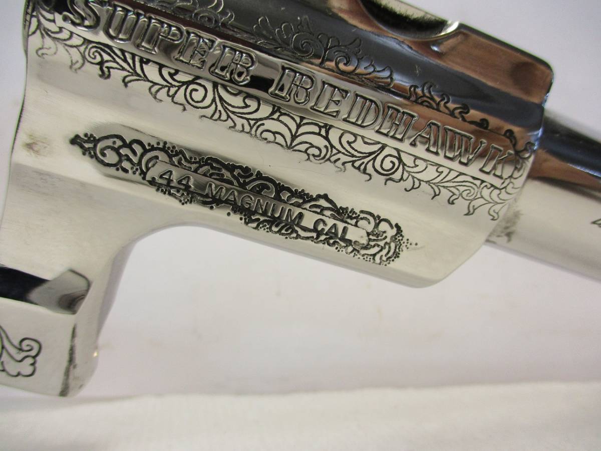

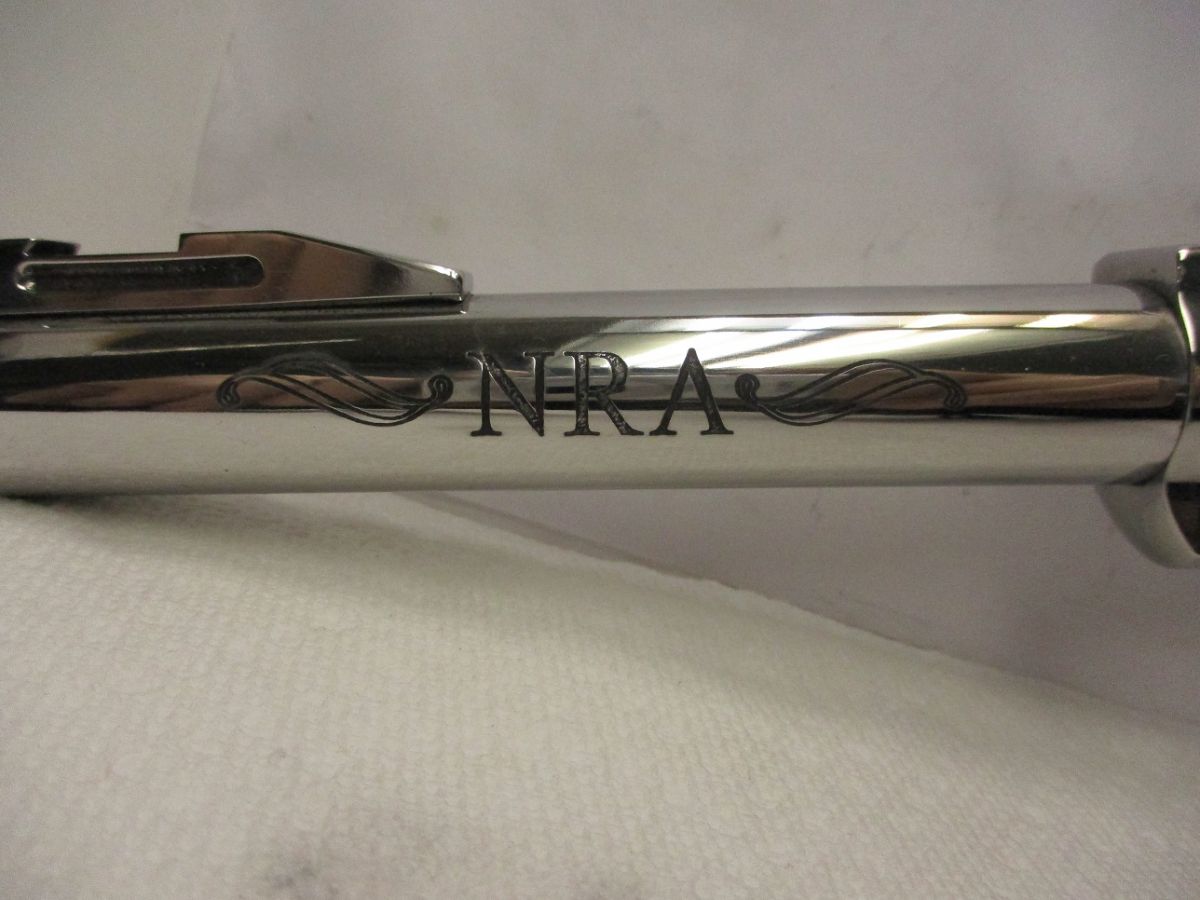

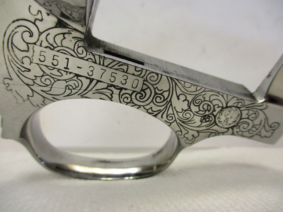

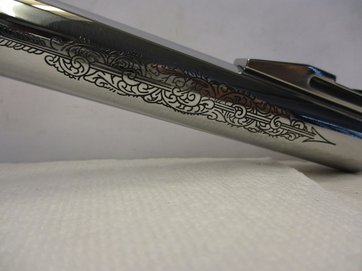

Nate did a great job of polishing the gun. I did the
gary reeder
Sunday, April 24, 2022, 18:47 (1659 days ago) @ WB
engraving.
by the way that is not etching. I etch the design in with
Monday, April 25, 2022, 10:42 (1658 days ago) @ WB
a special acid and template and then go back over it with a cutting tool and Gravermeister. That part is done totally by hand. On large caliber guns I don't like to take any metal out of either the gun or the cylinder so quite often I just etch the design in. But everything is done by hand, no machine etching.
