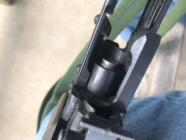

![[image]](images/uploaded/2022053002292462942c04ab18c.jpg)
You can see the shiny marks on the datum line of the case shoulder and some bottom marks on the case mouth around the bullet. I've checked everything and I think that's what it is. So I'm ordering GO and NO GO gauges (renting them actually) and a chambering finish reamer to possibly open it up ever so slightly so the shoulder and case can move deeper just a few thousandths of an inch and allow the bolt to close fully and easily after popping over the extractor groove.

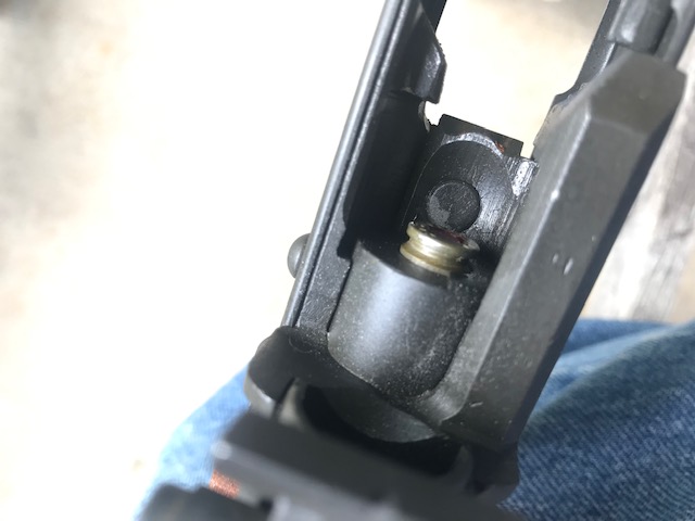

![[image]](images/uploaded/2022053002330562942ce1d3c0d.jpg)
Tiny difference perceptible with the AK74 .22

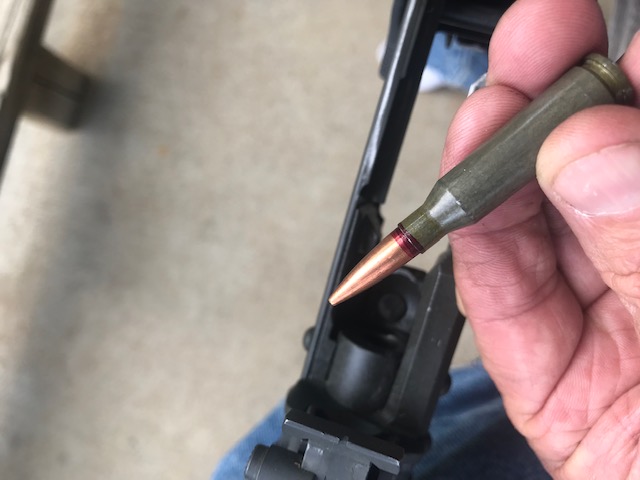

![[image]](images/uploaded/2022053002333562942cff0c995.jpg)
In operation that how the AK works. A round is stripped off the mag, bottoms in the chamber, the bolt extractor pops over and into the case extraction groove, and the bolt rotates to lock in the receiver and releases the disconnector which allows the trigger group to function with a closed bolt assy.
