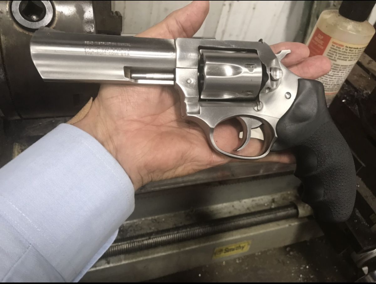

Nice little trail gun made even more versatile
Tuesday, June 07, 2022, 16:43 (1615 days ago)

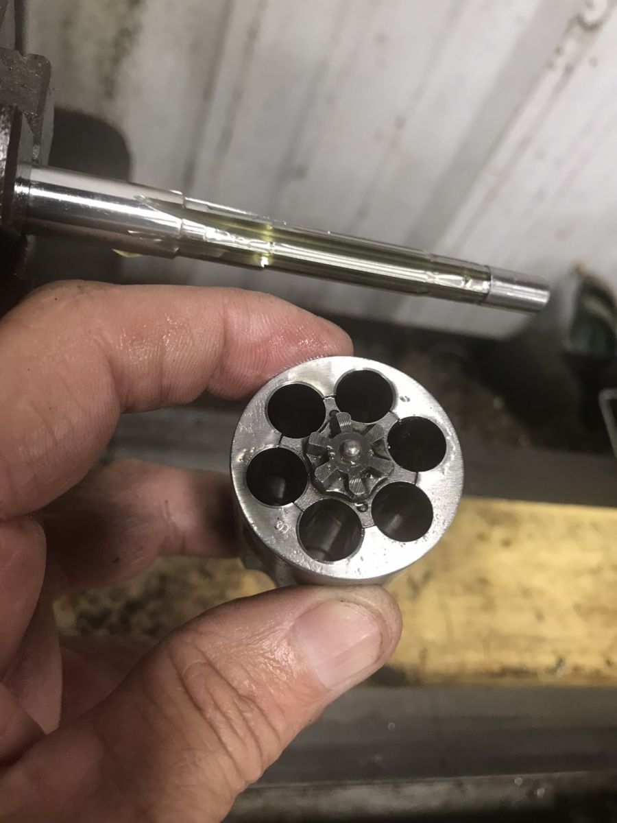

In a pinch most .32 ACP will run if you remember to point up to extract. .32 Short and Long are no problem. Sometimes finding .32 H&R OR .327 can be spotty. Nice to have all options open.
Fred’s tools must have pet names ($220 deposit if broken) so I do exactly as he schooled. Never broke one, never want to. Keep clean, lubricated, no heat. I’m cautious and take my time, blowing chips 3x per hole. Plus it’s only a finisher to lengthen and re-angle the chamber mouth.
I got it done. 4th or 5th time I’ve played this same game. Ruger stainless can be a wild card, so can old nickel plate!
I wish it was a newer model but it has clean lines and will do nicely. I’m teaching myself stuff.
Not to imply I’m ‘smithing without a Federal license…
