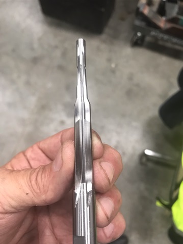

I have this too tight headspace AKM to try to fix today, for myself. A guy put it together and we bought it at a gun show from an FFL. The guy lied to us as it won't chamber on available ammo. All you can get is that awful steel case stuff. Brass could be forced, but not steel. I need just a couple thousandths deeper on the shoulder to let the bolt lugs kick over and lock. If I can only get this tool in and in a working position. Removing the barrel is not a favorable option for what I need done. I'm thinking a bunch for just a little work.
The expensive and exotic 5.45x39 finish reamer. It's borrowed so I mustn't break it!

- AK barrels are very crudely pressed and riveted in place - WB, 2022-06-08, 14:59
