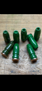

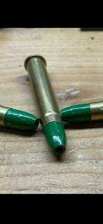

I practice with 260-270 grain bullets in the 378GNR. The barrel is super clean with these. They weigh from 261, 265, 271 depending on the size of the HP.
