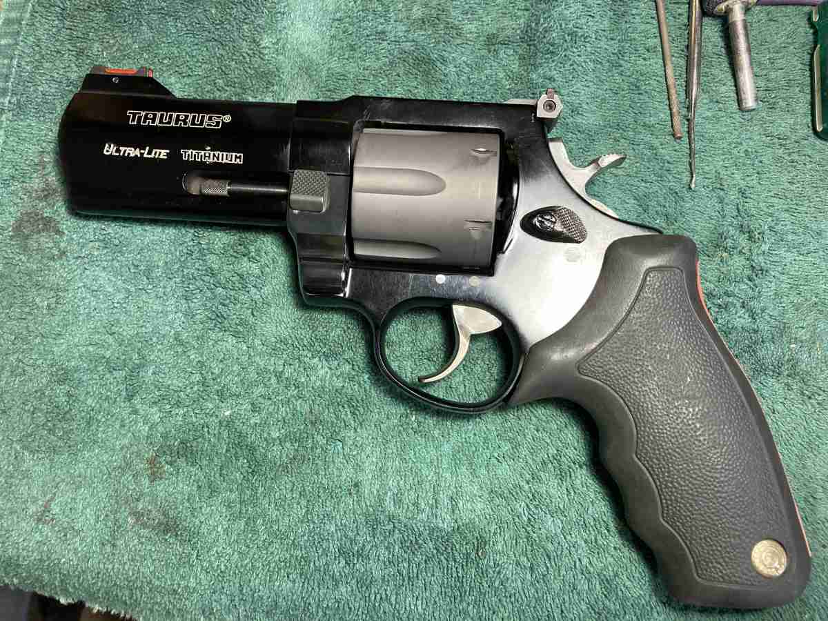

I have a thing for light weight carry guns. Have had a Taurus total titanium snobby in 45 colt I have carried since the late 90’s. Mostly in the woods or in a day pack. I picked up. Taurus 444 titanium in 44 mag on GB for too much money as it goes nowadays. Got it from a sheep herder’s supply stir in Idaho. Gun looked like it spent a winter in the snow in the bitterroot’s! Some surface rust/ pitting on the steel parts but otherwise functional. Be a good muck through the woods gun for Georgia. It either cold and wet or hot and humid here all the time. I cleaned up some of the small parts and replaced a few small parts they where available. You can get some small parts from Taurus for $6-7 or get used for $15-16 go figure! ![[image]](images/uploaded/202208211334196302345bd5b79.jpg)
No 44 mag ammo available so pickup sim 44 special Shot to point of aim and recoil was nothing. Loaded some 200gr jhp with 800x thinking the smaller charge weight would reduce felt recoil a little. It shot well but the fast power flame etched the cylinder! Switch to 4227 and that fixed that problem. The cylinder gap is pretty large at 10 thousand, but fine for a gun that is to be foul weather carry gun. K![[image]](images/uploaded/20220821134051630235e361208.jpg)

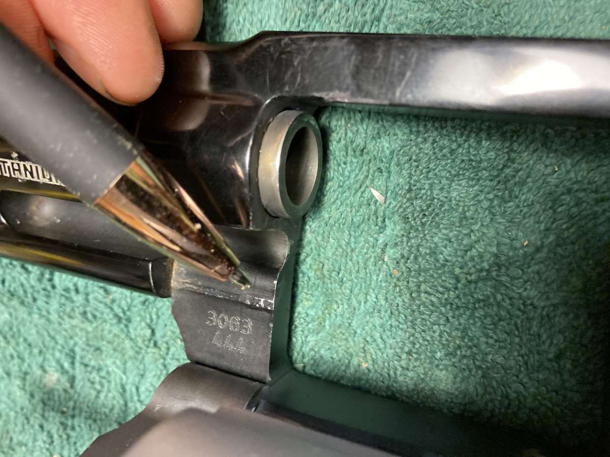

I found on eBay a cylinder and crane for $150 so I thought I would have some fun and see what I could do. The cylinder was about 25 thousand longer and the ratchets about 10 thou longer too so it was not going to be a drop in!
The ratchet was cut differently too. So I used a diamond hone to take down the ratchet to give me the same clearance the original cylinder had. Then honed down the barrel so it was square and gave me 2 thousand cylinder gap. With I thought would be good for a gun that I would carry a lot and shoot a little.

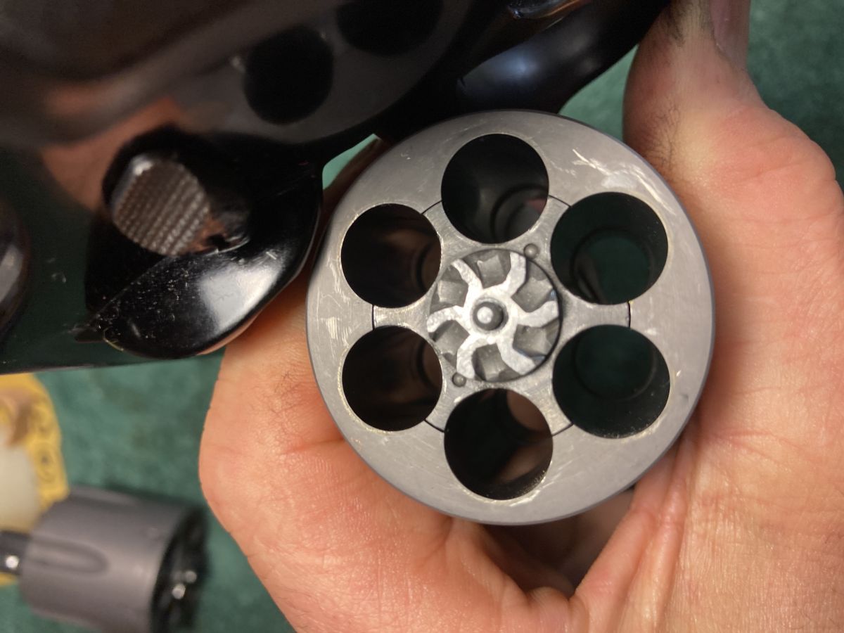

Next was the ratchet cocking the revolver the hand would not go through the top of the ratchet slot after the cylinder locked in the stop. So had to open up the ratchet. Used a drimmel ![[image]](images/uploaded/202208211350566302384057d31.jpg)

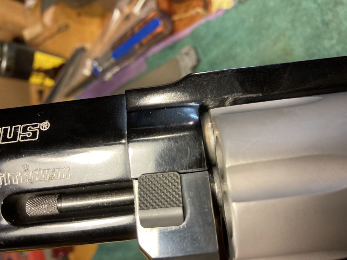

And here is the new cylinder gap ![[image]](images/uploaded/2022082113521763023891a7657.jpg)
Lastly it was the lockup of the cylinder it was binding on the locks a tad. So had to take about 4 thou out of the stop.

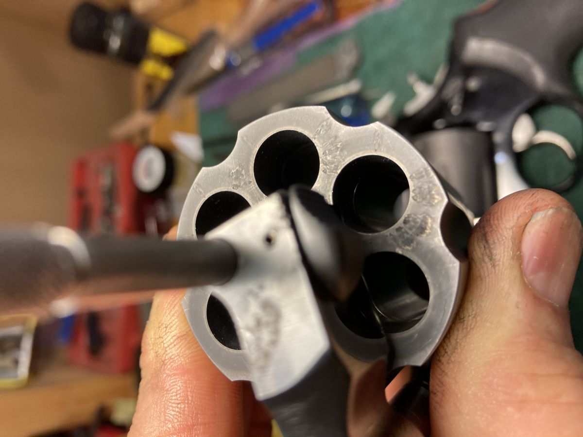

![[image]](images/uploaded/20220821135502630239367eae3.jpg)
Now it locks up tight, the cylinder has a few thou to move in every axes. I can shoot several cylinders full with out a problem with the cylinder gap. It’s smooth in double action and single. I think it came out great. I am sure Gary will be rolling is eyes and shaking his head! I am not a gun smith but have water boy and Jim Taylor tendencies
