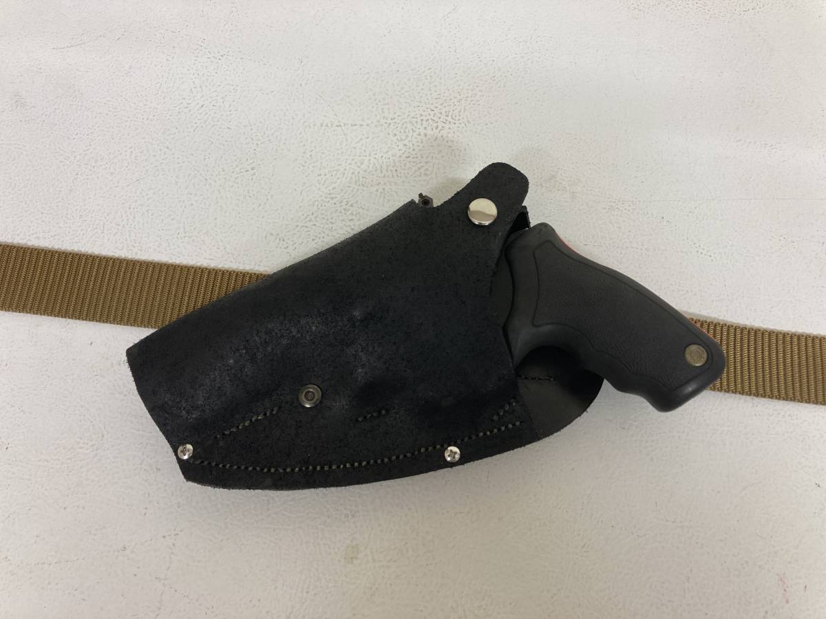

Oh yea made a holster for the small of my back
Blake
Sunday, August 21, 2022, 07:10 (1540 days ago) @ Blake

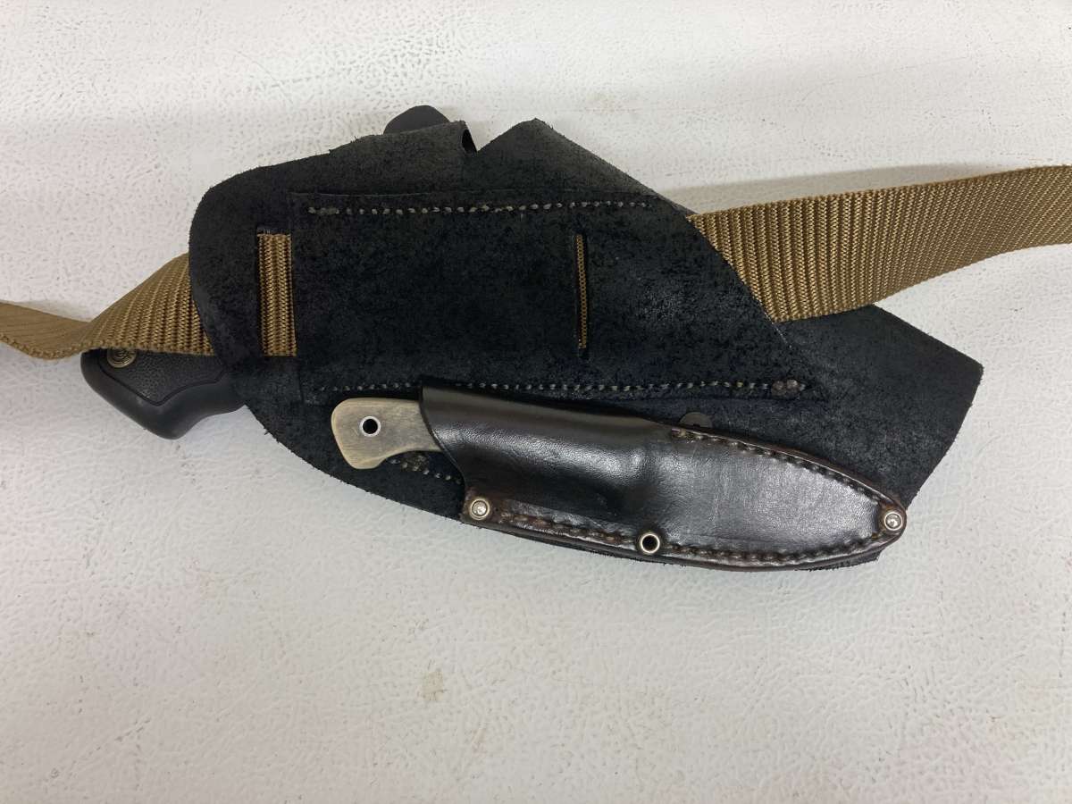

It works great if you carry a day pack or cutting wood keep the gun out of the way of the elbows
Also has a place on the inside for a EDC knife [image]
