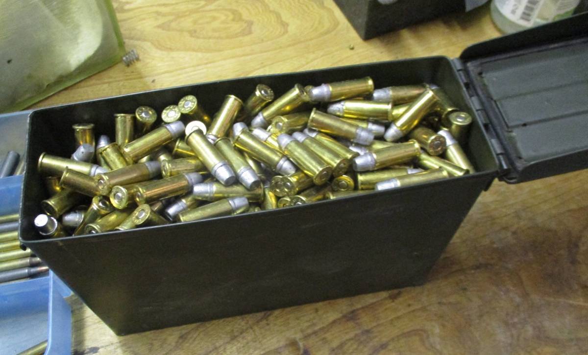

My "heavy" load ... Keith 250 gr. SWC and 16.5 gr. 2400.
