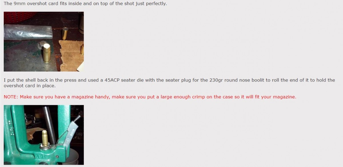

Using a turned down .45 ACP RN seater plug for rolling the noses is genius. I noted he necked cases with a .40 die.
![[image]](images/uploaded/20221027165930635ab8f27783b.jpg)

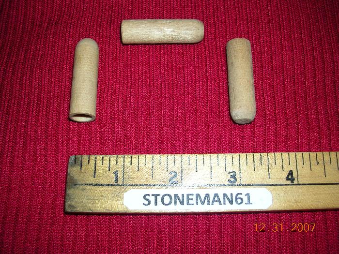

Wooden hollow bullet to hold shot....
![[image]](images/uploaded/20221027170005635ab915c6fa6.jpg)

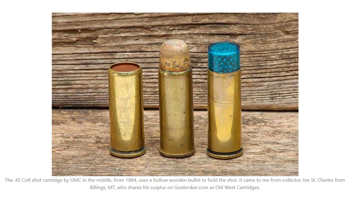

An ancient .45/70 version to be filled with shot or several .36 cal. balls. The wood is said to fragment on exiting the bore.
![[image]](images/uploaded/20221027170050635ab9429c4aa.jpg)

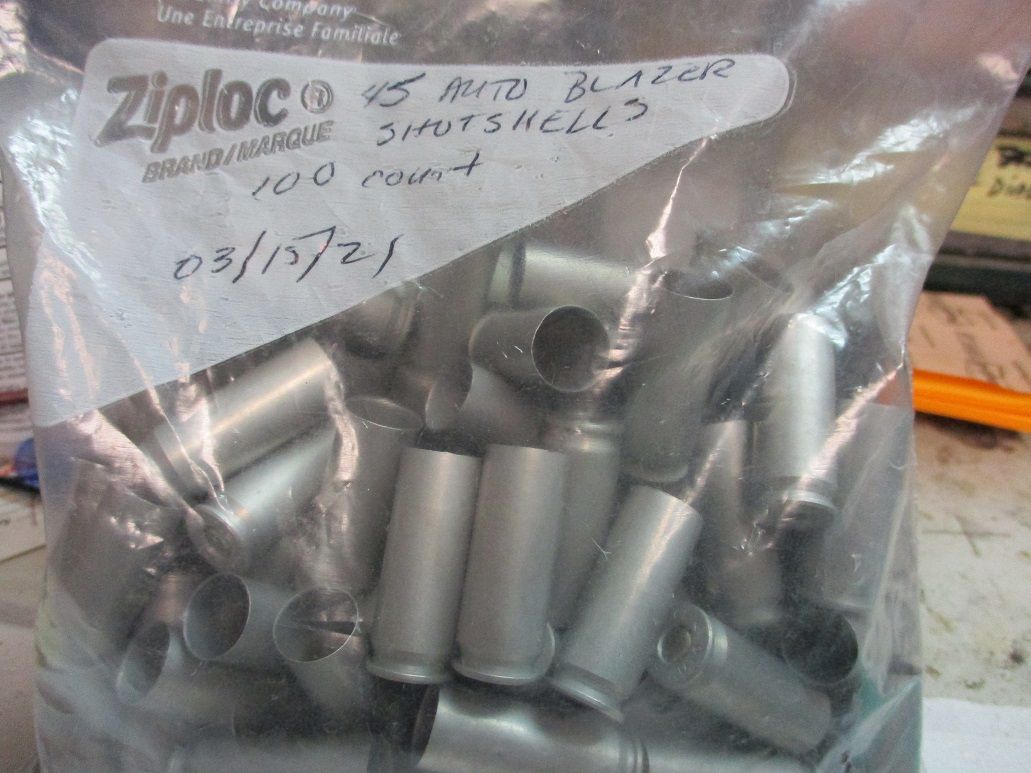

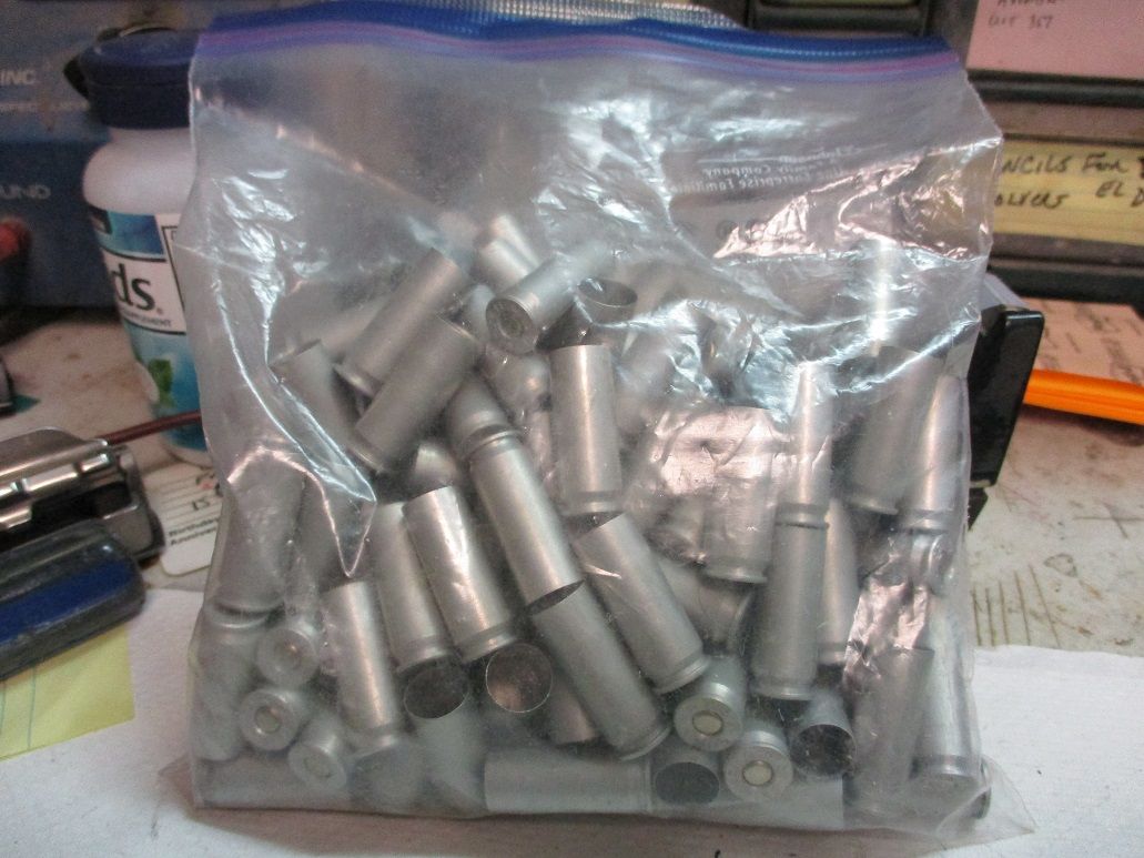

You clowns must be talking about these things
Thursday, October 27, 2022, 17:01 (1473 days ago) @ WB
I got these in a surprise package a while back. Just wondering who I dislike the most that I can send them to.
![[image]](images/uploaded/20221027235531635b1a73aa198.jpg)
![[image]](images/uploaded/20221027235546635b1a82b0167.jpg)
