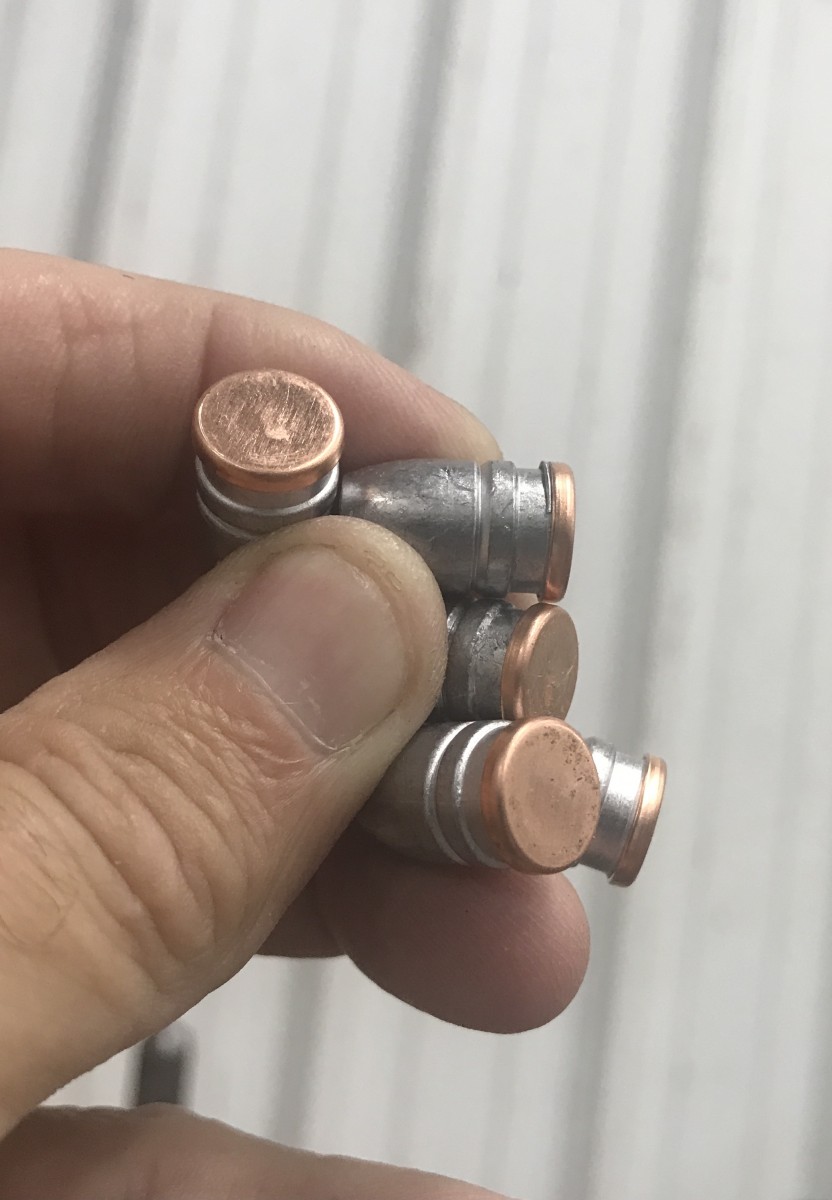

So I have $50 worth of very tight gas checks for these 10mm 200 gr. bullets. I've never figured out how that Lyman gas check seater is supposed to work. Never really messed with it. So I finger align and mash in the sizer. I probably need to sort a method of annealing the checks first off. Then I may use my own method of pushing the checks home without damaging the bullets. I MIGHT even size first in the LEE press then only lube with the Lyman. I thought powder coating but the checks would be murder to get on then. Perhaps .41 checks post powder coating?

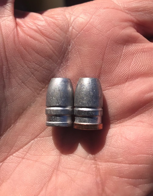

This shaving has plagued me often with many bullets. I have a good nose punch and think I'm being careful. Still I get 4-5% shaving. I don't want to send this to Irv so I'll shoot them. Has anyone seen this or figured the issue to solve it? This was on a cold first run, maybe once it's hot and greasy it will be less prolific.

The checks are really tight. Once on I think that may
Thursday, November 03, 2022, 06:23 (1466 days ago) @ Jim Taylor
be the best bet. Size on the LEE, then the lubesizer should not be in a bind and likely to shave. I guess I'm trying to do too much work in one pass for the old tool.

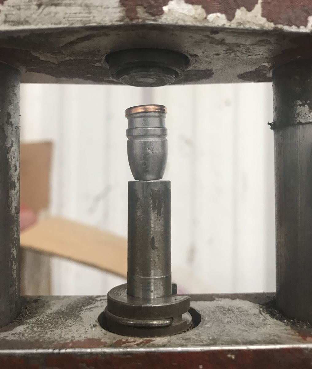

I screwed a .510 sizer in the press from under with the pusher stuck in the die bore. Then I’m using a .430 “pusher” to mash the bullet into the stop. I tried it both directions. I think upside down may be best.
Some throw up a little shaved lead from the foot on the shank but I think it’s home and square.
Use RCBS sizing dies...
JD
Thursday, November 03, 2022, 12:36 (1466 days ago) @ WB
Lyman sizing dies seem to often have a sharp shoulder somewhere and I get shaving. RCBS sizer dies (interchangeable with Lyman) are much smoother and I get no shaving with them. I've switched to all RCBS sizing dies for my Lyman 450 sizer...
