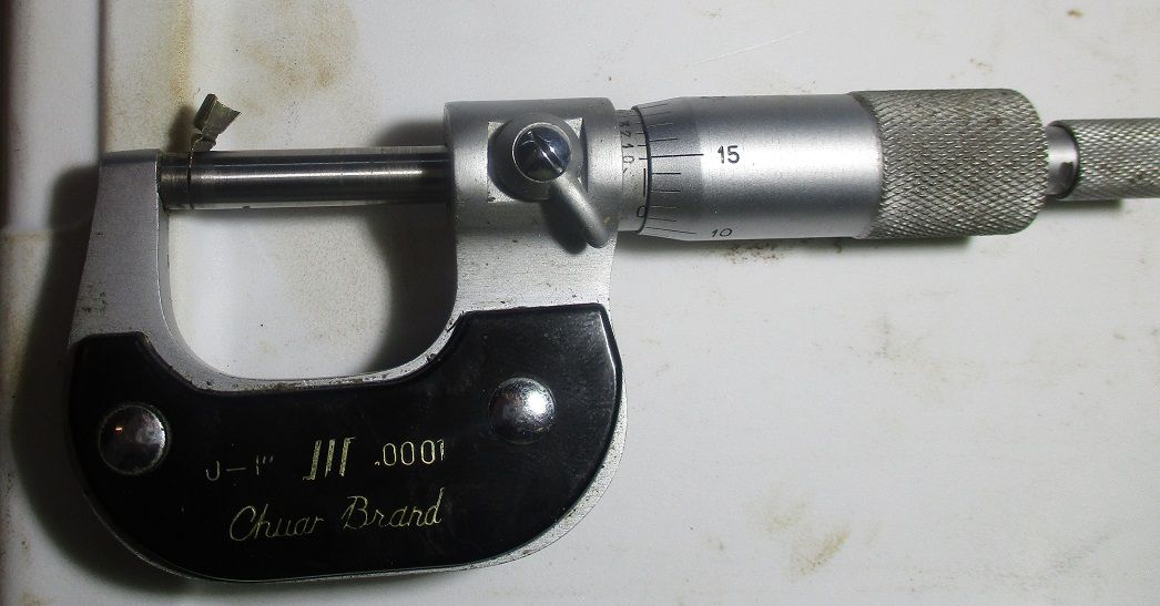

John ... I measured the caps I have from the 80's
Friday, January 27, 2023, 10:52 (1381 days ago) @ Jim Taylor
.015"

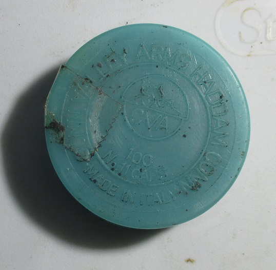

These were made in Italy for CVA
