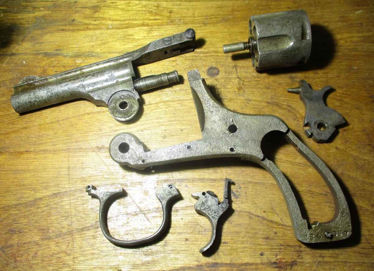

I am about at the point to start putting it together.
![[image]](images/uploaded/2023021000403263e5928073055.jpg)
The only thing I need is a cylinder hand. This one is gone. It's a little bitty thing about an inch and a quarter long.

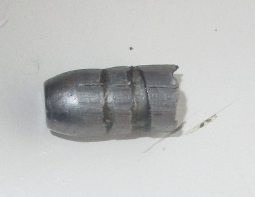

I understood the .38 S&W to be .361" but
Friday, February 10, 2023, 09:44 (1367 days ago) @ WB
I pushed a .358 bullet through the bore and it was tight!
![[image]](images/uploaded/2023021016442663e6746a833a7.jpg)
You've definitely
AmBraCol
, The Center Of God's Grace
Saturday, February 11, 2023, 06:13 (1366 days ago) @ Jim Taylor
engaged the rifling on that one. What are the chambers like? I'll admit to never having messed with 38 S$W, but have done a lot with the 38 Spl. Now you've got me thinking on the lines of using a 38 Spl sizer to "neck" the 38 S$W brass enough to grip a .358 cast slug. But that's just me cogitating here between the Canal and the Equator while sipping coffee on this warm winter's day.
I'm a peaceful man and prefer the pursuit of peaceful sports. Those involving teams and balls of any sort tend to be deleterious to one's body and promote violence by both spectators and participants.
A couple of the chambers are pitted ...
Saturday, February 11, 2023, 06:16 (1366 days ago) @ AmBraCol
but they will work with low pressure loads and using cut-off .38 Special brass and a round ball.
Does H&R call that a lifter?
jjones ![]()
Friday, February 10, 2023, 13:02 (1367 days ago) @ Jim Taylor
No. The lifter is the link that lifts the hammer.
Friday, February 10, 2023, 13:49 (1367 days ago) @ jjones
It's called the "hand" ...

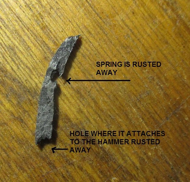

I found a cylinder hand .. now need a mainspring.
Friday, February 10, 2023, 17:58 (1366 days ago) @ Jim Taylor
The mainspring found me!
Saturday, February 11, 2023, 07:26 (1366 days ago) @ Jim Taylor
